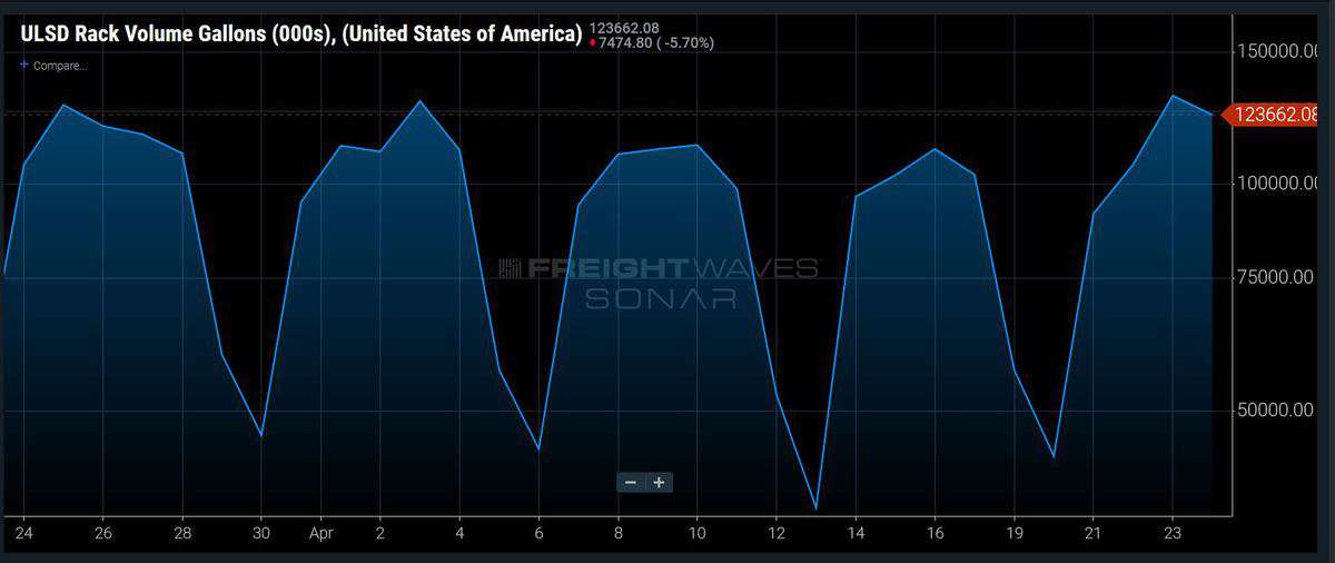

At the same time, the ULSDV.USA data series in SONAR on April 23 was reporting a jump in diesel demand of approximately 13.2% since April 16. The ULSDV records actual volume sold at the wholesale distribution point, known in the industry as the “rack.”
It is difficult to make perfect apples-to-apples comparisons between the two data series. First, the 13.1% jump in ULSDV.USA was recorded by comparing Thursday, April 23 to one week prior. The EIA data showing a jump of 11.8% was for the week ended April 17, so the date comparisons are not precise. Secondly, the EIA number includes other distillates like heating oil so it isn’t a perfect diesel-to-diesel comparison. But diesel is the predominant component in that figure.
However, there are some parallel trends. The EIA recorded declines in demand of -5.7% in the week ended March 20, -2.6% in the week ended April 3 and a whopping -38% in the week ended April 10. Meanwhile, the Thursday-to-Thursday comparisons in the ULSDV.USA series showed a decline of 11.25% in the week ending March 26, a drop of 8.4% in the week ending April 2, and then three consecutive weeks of increase: about 1% in the week ending April 9, 2.2% in the week ending April 16 and the previously mentioned 13.1% increase from April 23.
