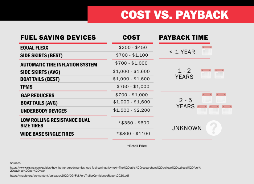

There are many fuel-saving devices on the market today that can help reduce costs. Bortner listed a handful of devices that range between $200 and $2,000 that fleets can easily install.
Fuel efficiency is also largely dependent on the type of tire and its alignment. Bortner noted a recent study by the Technology & Maintenance Council of the American Trucking Associations that suggests balancing all wheel positions across the tractor-trailer could increase fuel savings by 2%.
“All of the major manufacturers have made tires much better; these low rolling resistance tires, they’re getting fuel gains and are lasting longer,” Bortner said. Although wide-based drive tires definitely have a fuel gain, their heavy aluminum wheel frames aren’t optimal for every fleet.
However, don’t assume that pricier products will deliver more in savings. For instance, you wouldn’t want to invest in a device that won’t produce a return on investment for three years when the truck is to be retired in two. That’s why Bortner suggests it’s important to weigh the cost of the device versus its payback time.
