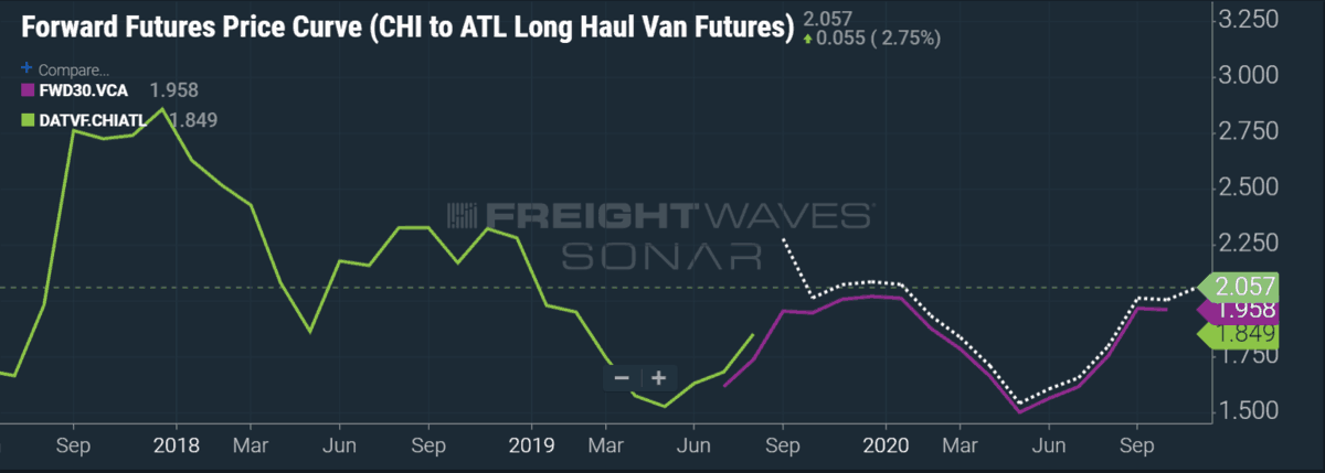

Sentiment on the Chicago-to-Atlanta lane continues to improve as freight futures traders place higher bids on September and October contracts (FWD.VCA). Compared to 30 days ago (FWD30.VCA), the entire curve has moved incrementally upward as we get closer to peak season.
(Chart: FreightWaves SONAR)
