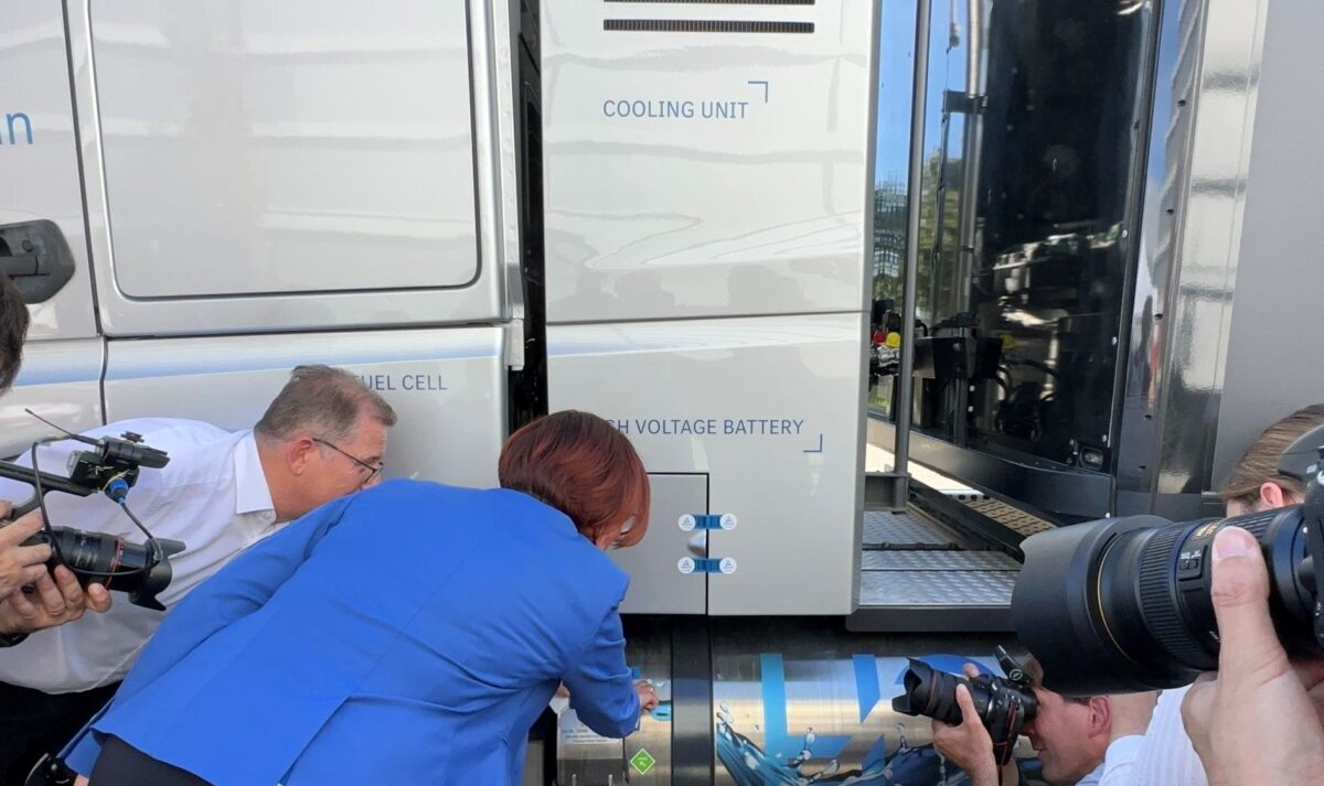

Sealed to avoid refueling
During the record run on Monday and Tuesday, a major goal was to avoid refilling the two 40-kilogram hydrogen tanks mounted on either side of the chassis. TUV Rhineland, a testing organization, affixed seals over the fuel inlet on Monday. The organization confirmed they had not been tampered with when the truck arrived in Berlin on Tuesday morning.
Officials apply seals to cover the fuel tanks for the single-fill run record of the Daimler Truck GenH2 heavy-duty semi before its record 650-miler run across Germany. (Photo: Alan Adler/FreightWaves)
