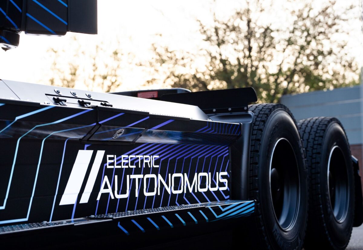

Daimler Truck added autonomous driving technology to its Class 8 electric eCascadia, creating a demo that addresses future markets for driverless trucks and emission realities that will eventually push out diesel fuel.

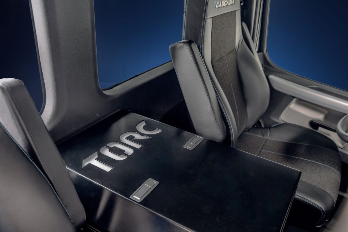

The demo unit placed the Torc compute unit between the driver and passenger seats — as well as under the passenger seat. The tight quarters presented a design challenge. Autonomous trucks typically use the sleeper cab space behind the driver for the units that compute trillions of bits of data per second.
Engineers packaged the Torc Robotics autonomous compute system between the driver and passenger seats of the Freightliner eCascadia daycab. (Photo: Daimler Truck North America)
An air cooling system and four 12-volt batteries assure the compute unit has sufficient operating power. Safety engineers required both seats remain in the truck so a safety driver and engineer could be on board to monitor the truck’s performance.
