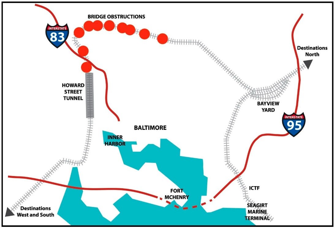

(Graphic: Maryland Department of Transportation)
But just in case, an array of sensors is keeping an eye out for any ground movement up on the surface.
“We’ve worked with the city and worked with the [Maryland Transit Administration] to be able to install those monitoring points to make sure that we’re getting good information,” Knapp said. “If we’re seeing any sort of movement, we’ll take action.”
