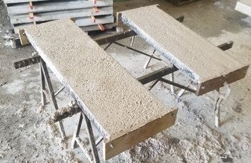

The pavement has allowed more than 25 inches of rainfall per hour to flow through its 1-micron-diameter pores in tests, according to AquiPor. The extremely small pore size is what makes it unique, Kunz told FreightWaves. He noted that no matter the size of the pores, they eventually clog.
But, Kunz said, “The difference is, there has never been a sub-micron-sized filter made as cheaply and easily as this precast concrete material. That’s an important advantage because, once the material clogs, it can be easily and cost-effectively replaced.”
In an internal study, the permeable material prevented more than 80% of particulate matter and pollutants found in stormwater from getting through.
Kunz described the material as “fine sandpaper” to the touch. The goal is to reduce runoff and standing water, potentially making the permeable pavement less slippery for walkers, bikers and drivers. In an upcoming mock-up, the company plans to analyze texture, abrasion resistance, emissions and other factors in a full cradle-to-cradle analysis, spanning from production to end-of-life for the material.

Bricks of AquiPor’s pavement drying. (Photo: AquiPor)
