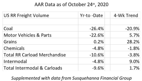

Table 1 shows two tales of the recovery as a focused list on those commodities that are most likely to somehow drive rail freight recovery.
The table identifies both the year-to-date and the latest four-week trend line into late October.
There were extremely disappointing decreases for coal and somewhat modest recovery for motor vehicles and auto parts.
Yes, high marks overall year-to-date for selected commodities like chemicals and grains.

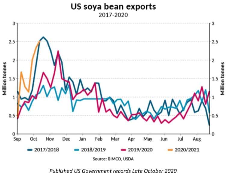

As illustrated in this soybean graph just released, exports are trending up markedly. Rail moves to ports are and will continue to benefit.
