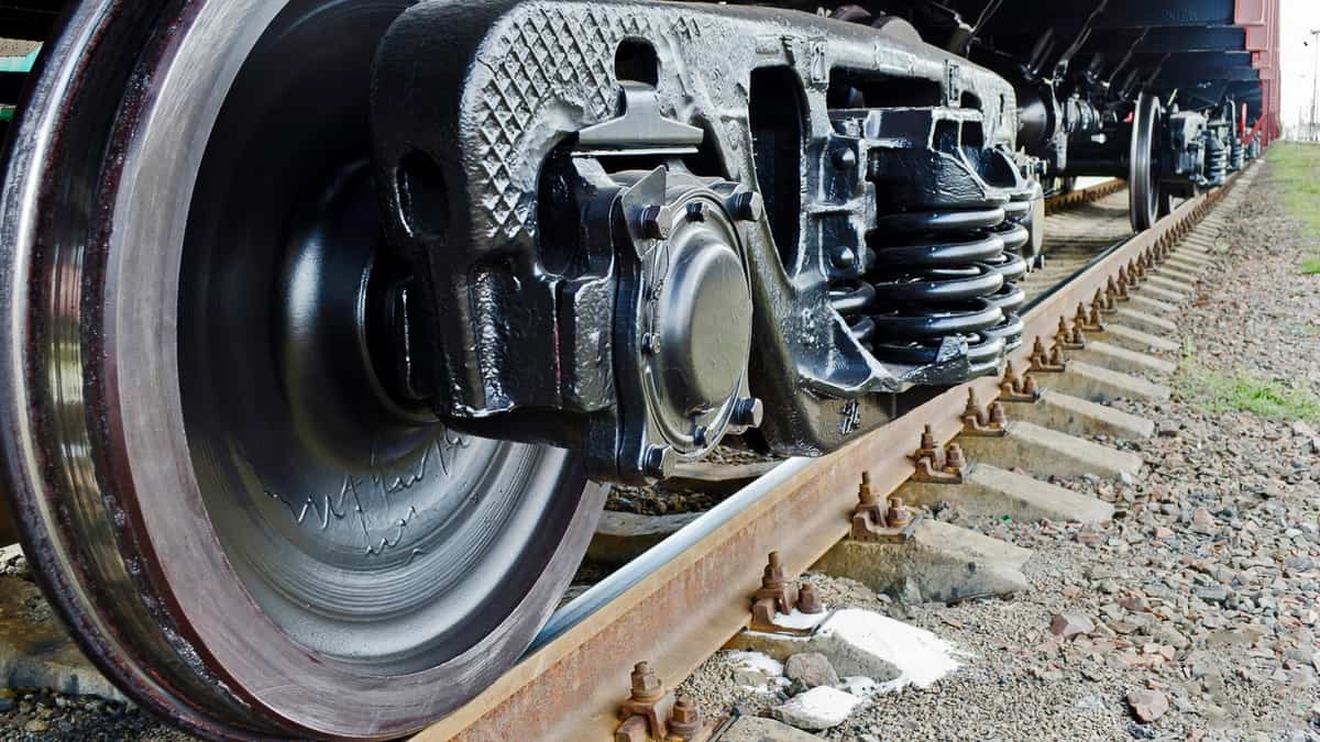

There were some other less-noticed changes. One change was in railcar parts design. As an example, in 2003 North American railroads adopted a new design standard for the railcar “trucks” for the heavier 286,000-pound railcar type.

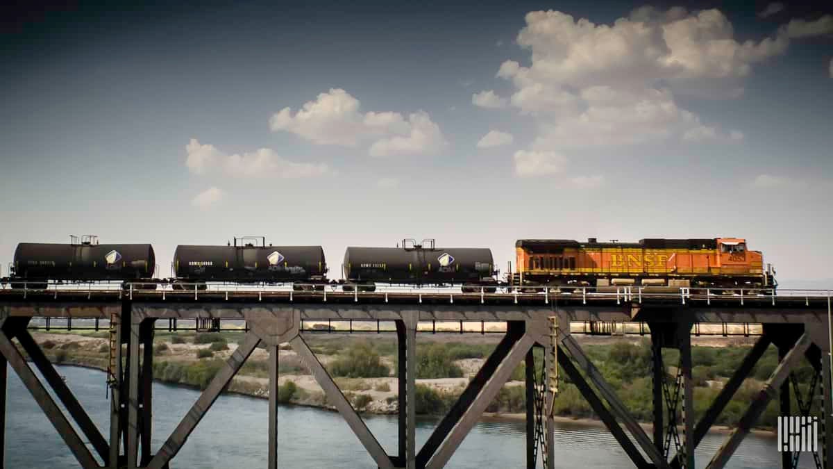

There were limitations. Only certain routes with high annual traffic density would be successfully migrated to HAL status. Bridge structures could also limit the HAL route options.

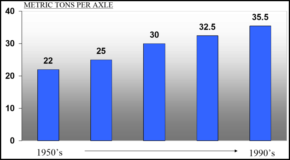

Migration of US Railroads towards heavier capacity HAL freight cars
Post-World War II period
Source: World Bank March 2006 presentation by Zeta Tech’s Jim Blaze

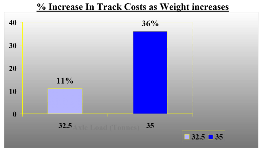

World Bank Zeta Tech exhibit – March 2006. This compares changes in track degradation that might occur when shifting from a 32.5 to a 35 metric ton axle loaded freight operation.

 Overall, Zeta Tech studies suggested there could be a 25% or higher net corporate integrated benefit compared to the original cost/capital estimated operations examined.
That net was after the engineering track costs increased by as much as 15% to 35% or more.

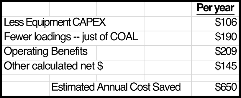

For an overall societal benefit answer, here is that scorecard range as calculated by Dr. Maitland a decade ago.
North American HAL big train technology benefits.
Net benefits after first deducting some added costs.
In millions of US $
Timeline: 1994 to 2010

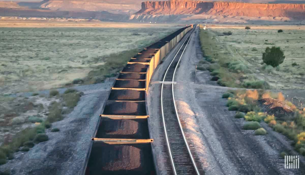

About 10 to 12 years ago, North America reached the point where nearly 100% of all rail-moved coal traffic in the western U.S. shifted to moving in either a steel or an aluminum HAL freight car with 286,000 pounds of capacity with axle loadings of about 32.5 metric tons on each axle.

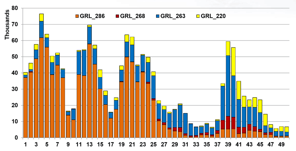

According to the AAR experts, here is the year 2019 North American freight car fleet as a graph showing the distribution by car age and axle load type. The data will be updated next week by Railinc’s David Humphrey.
GRL stands for gross rail load (weight). A 286k would be a 286,000-pound car.
The distribution shows the number of years by car type.
