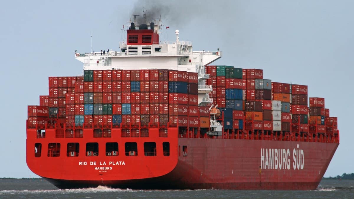

Hamburg Sud container ship in ocean
Box ships are now switching to low-sulfur fuel. (Photo credit: Flikr/Glen)
The famously dismal science known as economics suggests that if demand for low-sulfur fuel rises faster than the available supply (via refinery output and inventory draw-down) prices will rise in the near-term. Beyond basic economics are the logistical constraints of time, physical space and location. This means that some ports may have enough compliant fuel to service their customers while others may not. If this is the case, one cannot expect supply chains and ocean transportation networks to adjust quickly enough to prevent such a price increase. Until adequate fuel supplies are available where needed, the adjustments likely to take place would involve what one would expect in any large neighborhood where there is only one gasoline station. Drivers would either: hoard their fuel early on (creating traffic congestion in the area); or drive more slowly and plan trips carefully all the while hoping that a fresh supply will be on hand before the gas tank runs dry. In like manner, ocean vessels would curtail their speeds in-between ports of call and hope to ride out any shortages.
Yet things have not been dismal so far. To date there has been no price spike in diesel fuel – a low-sulfur option. This is good news given that IMO 2020 indirectly affects other modes of transport that use diesel fuel (i.e., trucks and railways). Very low sulfur fuel oil (VLSFO) also meets IMO 2020 standards and is available at the major ports (e.g., Rotterdam and Singapore). BIMCO, the world’s largest association of ship owners, characterizes VLSFO prices as having been on a “rollercoaster” since December 2019. The Singapore price peaked on January 7, 2020 at $740 per metric ton and has since fallen to $641 on January 22, 2020. Along the way the price spread between VLSFO and heavy bunker fuel reached a high of $340 per metric ton before falling to $284. Despite the narrowing price spread between the two fuels many carriers will likely invest in scrubbers. Installation cost per vessel starts at about $2 million and can rise to several million more. This is the classic cost-benefit problem of taking on up-front costs versus estimating the present discounted cost of a more volatile commodity over time. Still, BIMCO estimates that using scrubbers will take anywhere from 0.5 to 1.5 years to have a lower cost impact than switching to VLSFO. This range is dependent, of course, on the installation cost and annual maintenance costs of the scrubbers as well as the daily volume of fuel consumption.
