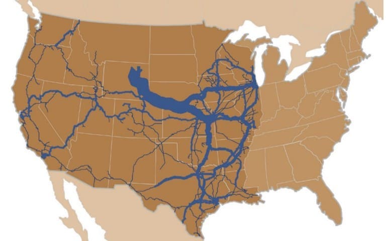

Various technical density maps are the next recommended source. They are rich in intelligence – if you learn how to interpret them over time periods.
Railroads periodically publish density maps that show freight volume over their strategic corridors. Where do you find such maps? They are found most often in a railroad’s Fact Books or in some specific commodity group corporate presentations. The map images are a specific statement of a railroad’s key routes. But changes over time can be spotted if you know where to look.
Source: Union Pacific Energy Commodities Density Map – Year 2018 Fact Book
Corridors that demonstrated shifts to significantly lower traffic density in recent years are one of the footprints you’ll need to interpret. As an example, what’s a drop of 20 percent or more in traffic density like gross revenue ton-miles (GTM) via one of five New Orleans’s rail routes mean?   You will need more than the gross-ton miles indicator and timeline to translate that data point.  Nevertheless, it’s a metric to consider.

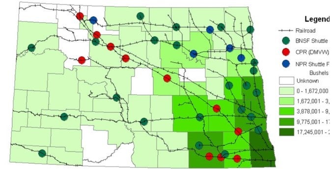

Here is one example of state assistance. It is a South Dakota State Railroad Plan Map of Strategic Railroad-Served Shuttle Train Elevators. Some are located on very light density lines.  Some sites may lack well-engineered rail track, ballast and ties for 286,000-pound loaded grain cars.

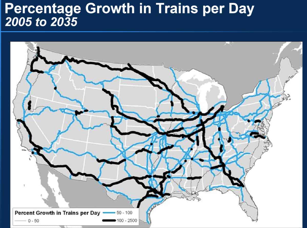

Be alert please. Not all published maps are still valid. This map with a projected change in traffic volume out to the year 2035 was well-researched and presented when published a little over a decade ago. But it is out of date because of changes in the market and the restructuring that railroads have undergone – and will continue.
