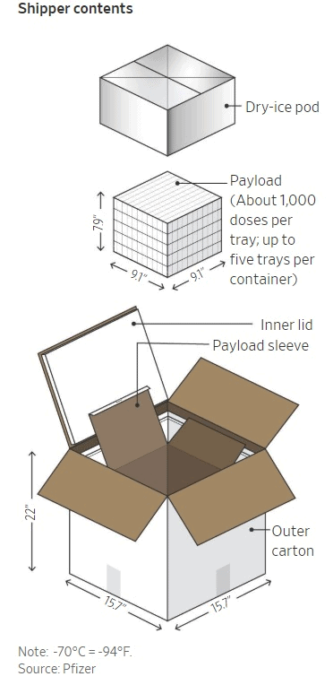

The critical pieces supporting this chain are the packages and containers that will house the doses and hold them at their critical temperatures during storage and transport. These doses will be placed in special packaging or third-party packaging that fall into two categories: active and passive. “Active” packing consists of powered large containers or boxes that contain an air-conditioning unit that is either electrically charged or gas charged so the unit can maintain a certain temperature. “Passive” packaging consists of specialty boxes that can be finely tuned insulators or containers that use dry ice to maintain temperature.
Source: Pfizer

“Pfizer developed a special shipping box that uses dry ice to hold between 975 doses and 4,875 doses of vaccine,” said Sharpsten. “This shipping container is essentially 20 inches by 20 inches by 24-inch box with different thermal layers in it, and these shippers have what’s called a passive time temperature indicator to maintain cold-chain quality control. Pfizer will ship packages with dry ice.”
Tanya Alcorn, Pfizer’s vice president of biopharma global supply chain, has publicly said Pfizer will make its own dry ice.
According to tests by Pfizer, unopened these Pfizer shipper boxes maintain minus 80 C for up to 10 days. Operation Warp Speed received a sample of the shipper at headquarters and has been going over the product daily. “We are picking it apart and putting it back together to make sure we understand it,” said Sharpsten.
