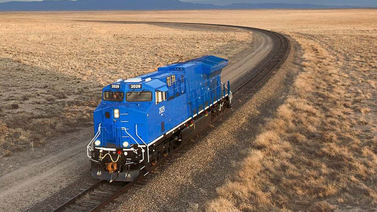

A bright blue locomotive moves down the track on a wide-open plain.
(Photo credit: General Electric)

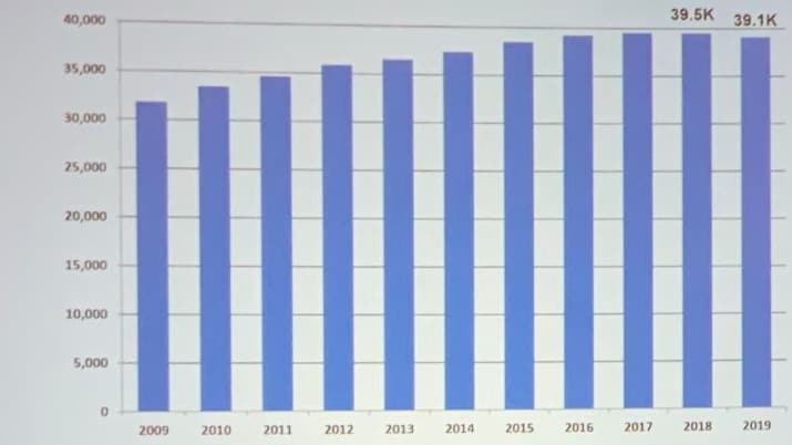

There were 39,100 locomotives registered in the North American official UMLER fleet file as of the end of December 2019. A 20% stored estimate would be ~7,820 units. A 30% stored estimate would be about 11,700 units.
Here in a graph is how big the fleet of UMLER active locomotives is as of year-end 2019.
(Graph data souce: Railinc.)

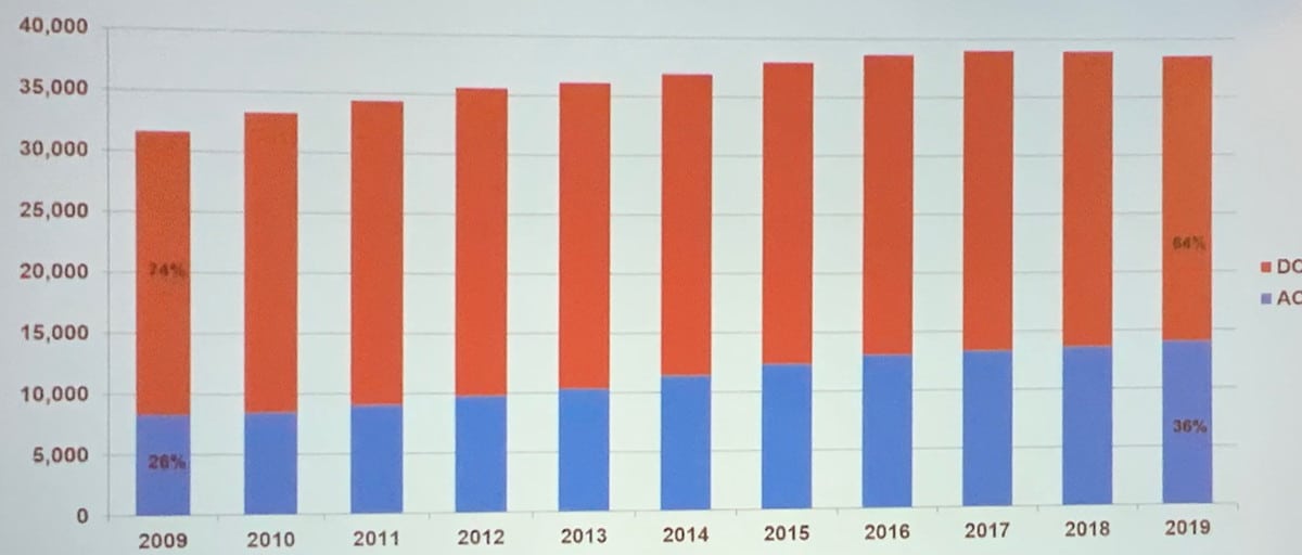

Over the past two decades, most of the main line locomotives switched from direct current (DC) power to more efficient alternating current (AC) power. The next graph shows the distribution between DC and AC units.
(Graph data source: Railinc.)

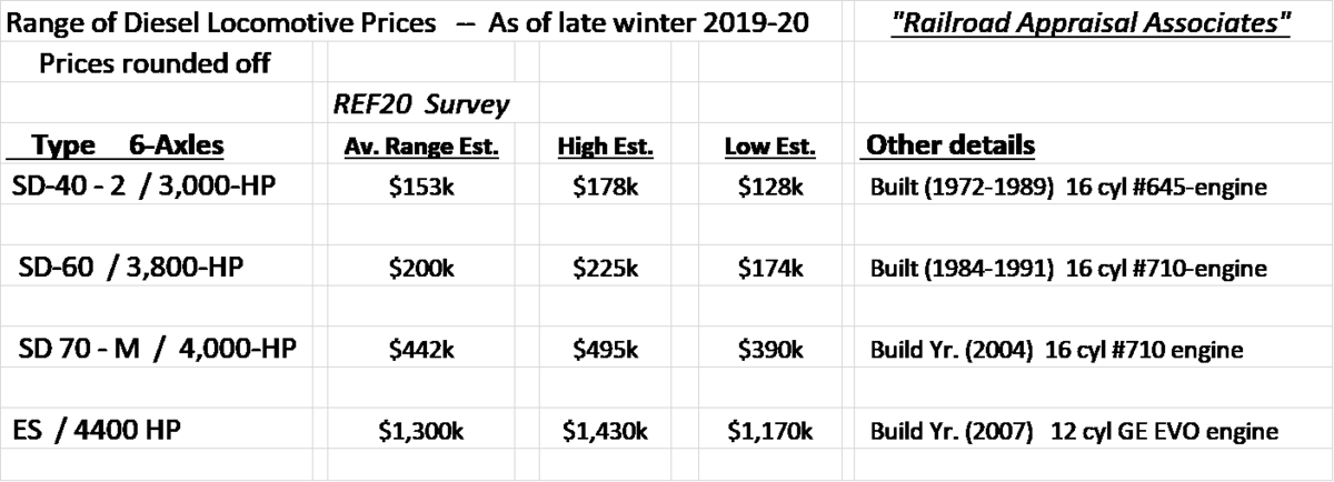

Here are just a few examples of the resale prices as of late winter 2019-20.  Prices might be even lower now in the spring. The price estimates are for units still in good physical condition.
Prices are a broad estimate and not necessarily statistically accurate as to sample size. It is an attempt to discover the range of reasonable market values.
Remember that multiple brokers who specialize in these types of transactions should be consulted for more accurate estimates and negotiations with sellers.
(Graph source: Railroad Appraisal Associates)
Note that the cost to modernize these units as extensive rebuilds with new electrical and traction control upgrades would involve additional capital investment.
The four diesel-electric locomotive types shown are typically among the most used locomotives in the North American market. Each type has its own strengths and weaknesses.
Given the recognized long life of railroad locomotives (40 to 50 years – and sometimes beyond), these units were selected as ones to consider instead of buying a new mainline road unit at $2.5 to $3.2 million price ranges. A modernized and rebuilt unit price is perhaps in the $1.5 to $2 million range.
