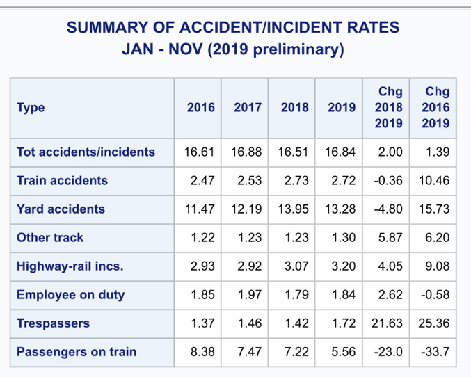

Figure 2
Summary of rail accident/incident reports 2016-19
Recent two-year pattern

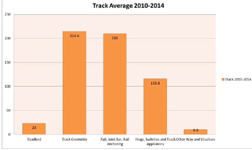

Figure 3.  An evidence graph from the 2015 Pennsylvania report
Reasons for track-related accidents (2010-14)
If it is a track defect-related cause, here is what that cause pattern looked like back in 2014.
