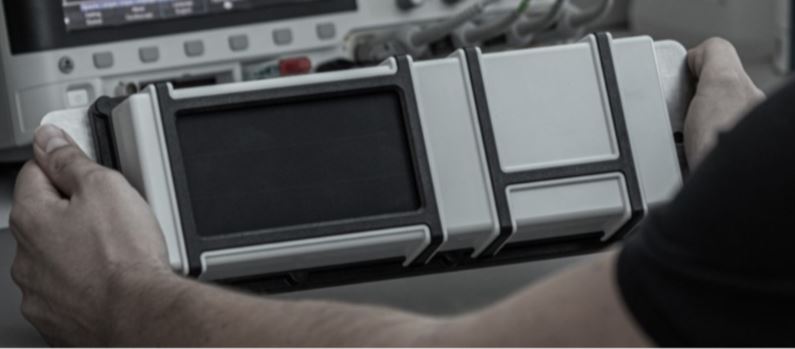

The image below is of a device Nexxiot is already marketing across Western Europe and now here in North America.
The product name is the Globehopper Crossmodal sensor.
The device is larger than the simple RFID AEI rail equipment tag introduced in 1990-95.
Nexxiot is already marketing its subscription-based service.
Nexxiot positions itself as a logistics supplier of TMS-relevant data applications. It is not just a sensor manufacturer. It has a business record from its work with railroads and rail customers in Europe.

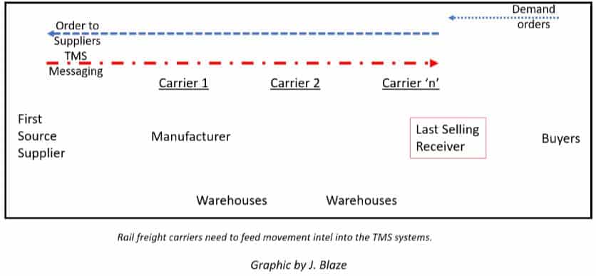

What the customers are going to need is an easy-to-capture messaging application. That is software.
That software-delivered intelligence needs to integrate directly with a customer’s internal inventory control software — which logisticians refer to as the transportation management system. The TMS systems control the separate ordering, moving, receiving, storage, and then the delivered or sold merchandise stage.

Simple market supply/demand logistics chain
Carriers including rail, truck and ships are in the middle of the process.
Communications ordering, tracking and fulfillment digital links are considered as TMS enablers — or data feeds.
