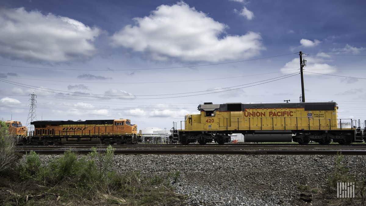

BNSF locomotives and a Union Pacific locomotive.

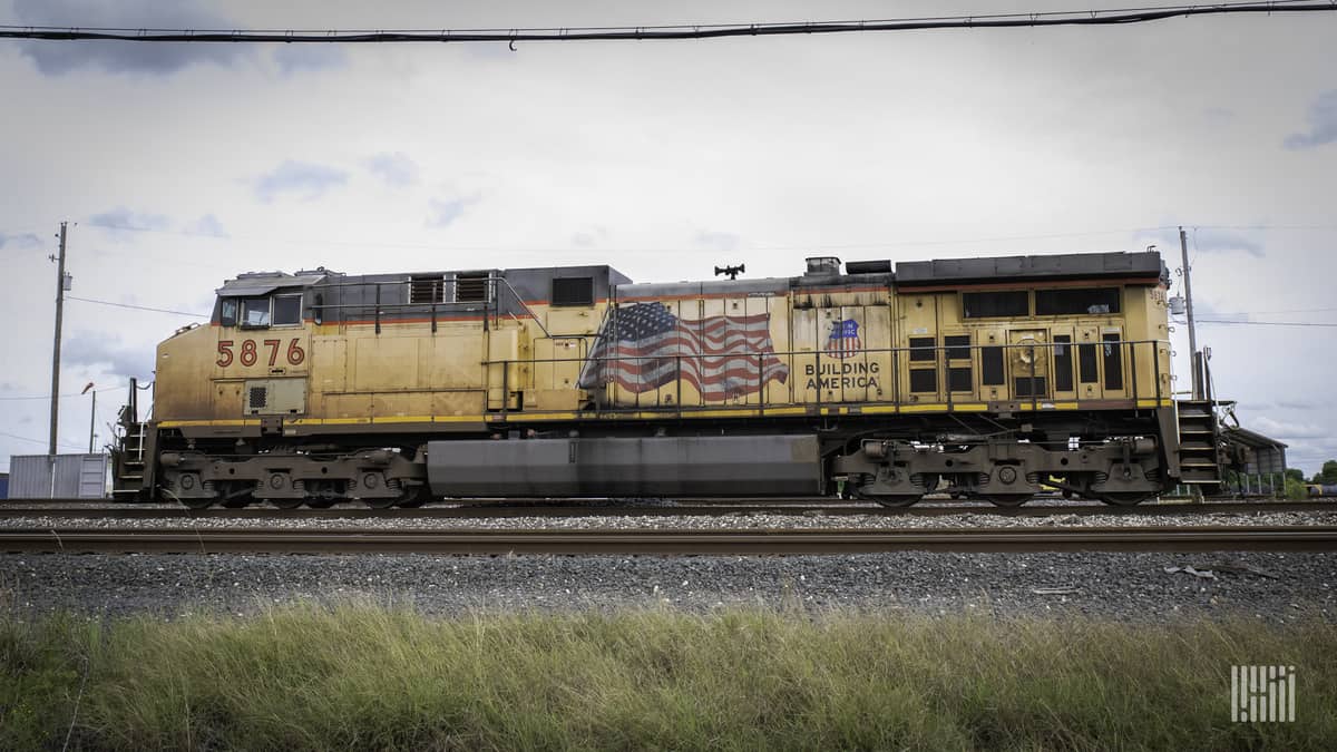

A Union Paciic locomotive.

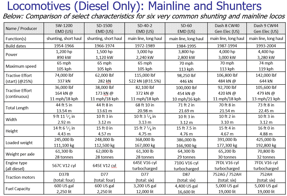

For comparison, here are several different baseline OEM locomotive types which may be candidates for modernization.
Table courtesy of Jeffery.Whitney@Interres.biz

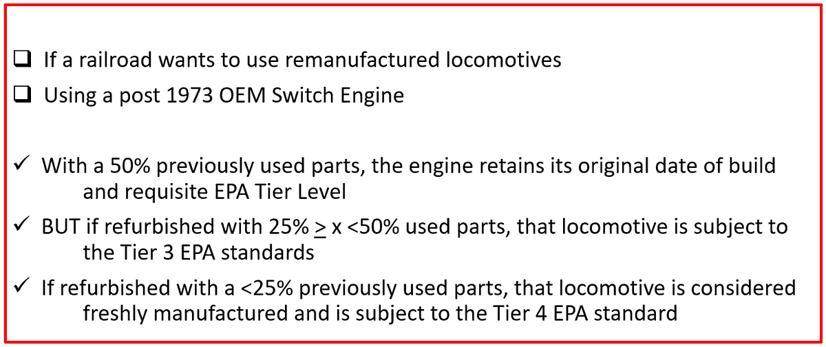

There are regulatory rules that determine how a unit is rebuilt. Specifically, U.S. Environmental Protection Agency federal pollution rules apply.
The EPA also mandates that locomotive upgrades can’t exceed more than 50% of a locomotive’s value. Therefore, most locomotive rebuilds are fitted with a remanufactured engine instead of a new one.
Engine preservation and reuse is a special role for companies like National Railway Equipment (NRE).
NRE crews remove the old engine from the locomotive and then employ special machinery that restores all dimensions of the original diesel engine. This includes power assembly, heads, liners and pistons.
NRE remanufacturing “essentially like new” helps meet the EPA “parts content” standards.
Here are the environmental rules that are important based upon a REF20 recent rail equipment presentation by NRE experts.

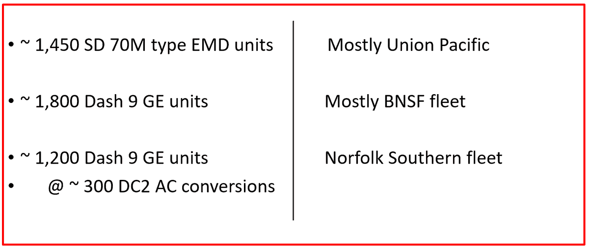

Which railroads have used locomotives in good condition for rebuilding?

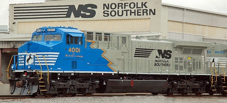

Another critical part of an upgrade involves switching out the traction motors that deliver power to the locomotive drive wheels.
One of the ways to obtain higher productivity is to convert the older units direct current (DC) motors to an alternating current (AC) technology. AC motors give the engineer more control over the wheels. That control improves locomotive steel wheel adhesion to the steel rails by reducing wheel slip. Also, AC technology is heat-resistant – and has a much longer service life before failure or repair. In a DC-to-AC modernization, the locomotive will receive new “trucks.”

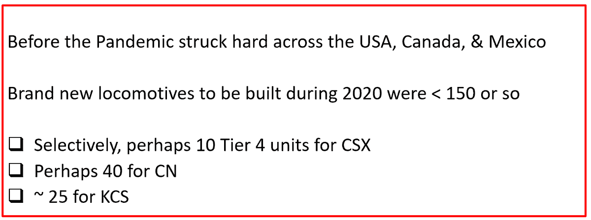

Here is the current mid-May outlook for 2020. New locomotive orders will be depressed. It’s possible that fewer than 100 new units will be delivered.
However, selective rebuilding/modernization will continue – albeit at perhaps a 25% lower rate than budgeted for the year as the railroad boards of directors approved their Class I railroad capital budgets at year’s end 2019.

The BNSF AC44C4M is a GE C44-9 rebuilt with AC traction motors. The internal controls are like those of the newer GE ES44C4 – at a cheaper price.

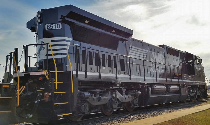

Norfolk Southern already has about 160 of its Dash 9-44CW units upgraded to an AC rebuilt power series of the “AC44C6M” type. This program is expected to continue into year 2023. But, check the second quarter NS investment report for an update sometime in July.
Norfolk Southern GE Dash-9 conversion to an AC44C6M type from DC to AC in 2015.
(Photo: Mike Ray)
