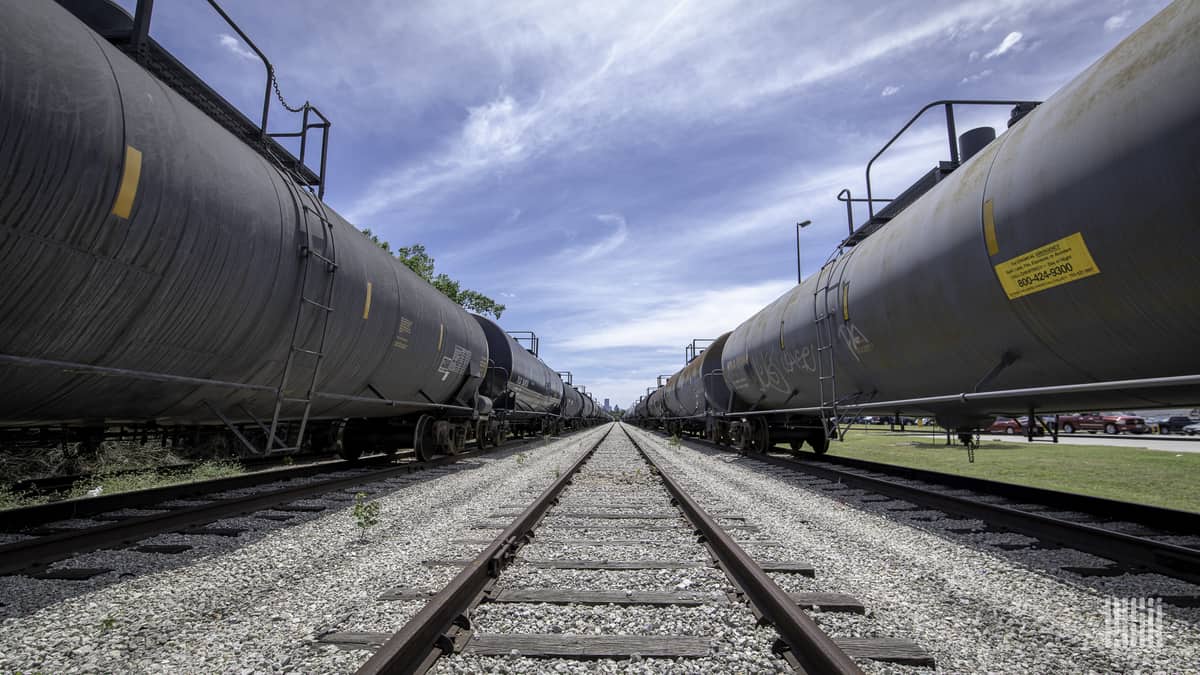

Tank cars sit on two of three tracks visible in this photo
Tank cars sit on two of three tracks visible in this photo.

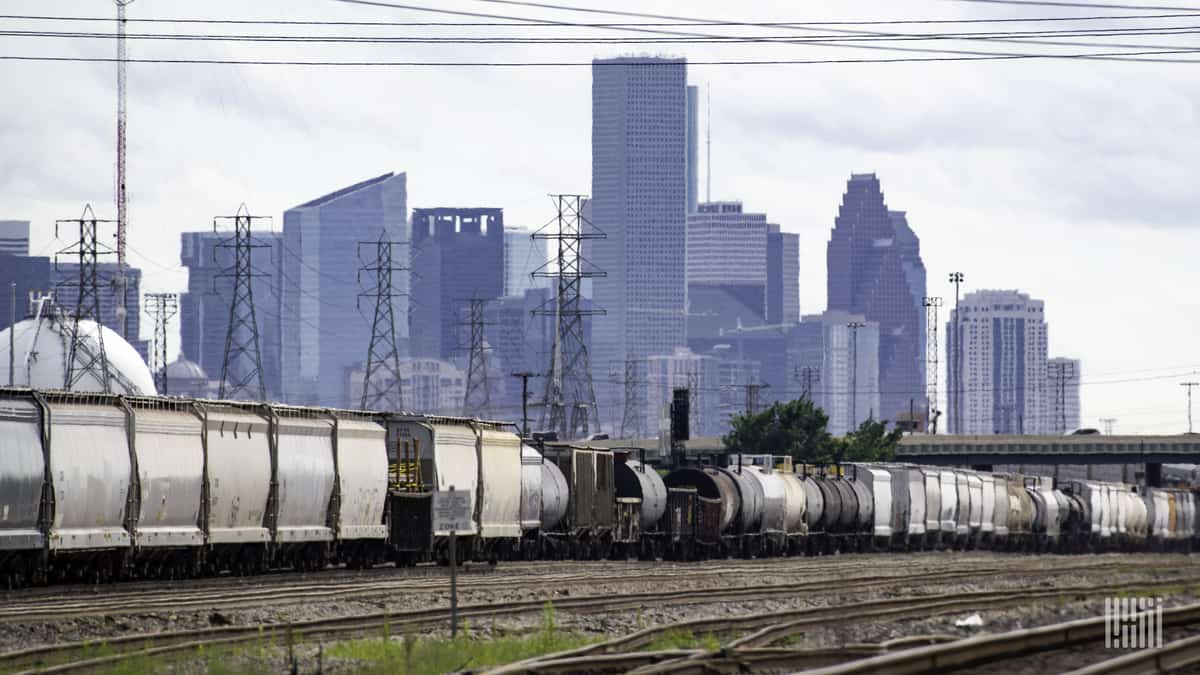

  • Yards (collection of tracks) for marshalling the train sets
A freight train sits in a marshalling yard near a major city.

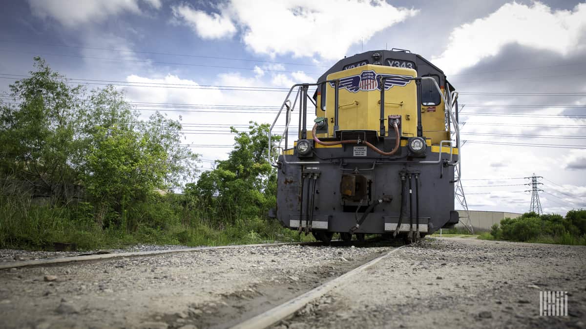

A Union Pacific train on a track with what appears to be little ballast.
The cheapest thing one can do to preserve the strength of the track is to generously use stone ballast. It is relatively cheap.

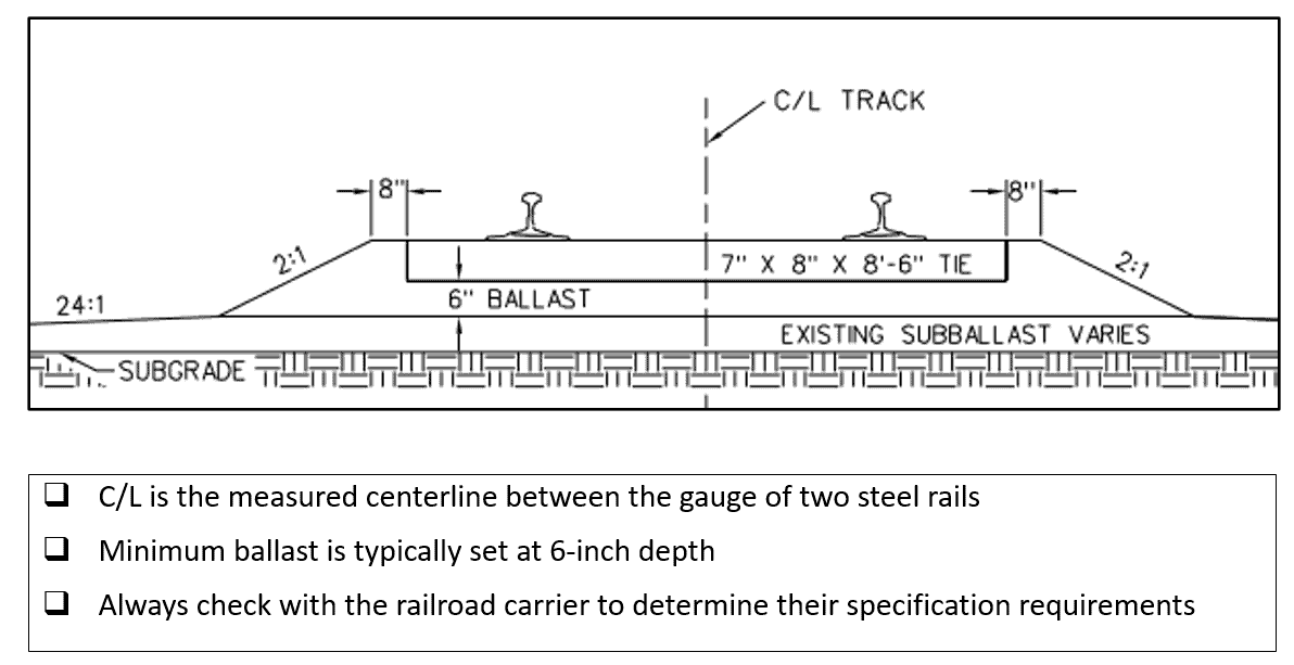

So how much ballast should we deploy? The rule of thumb is about a one-foot depth (30.48 centimeters).
Here is a simple best practice cheat sheet for rail freight ballast.

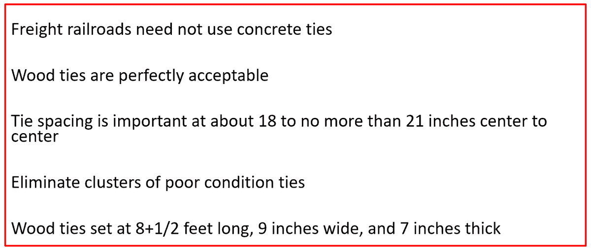

Here is the best practice check list for railway freight ties.

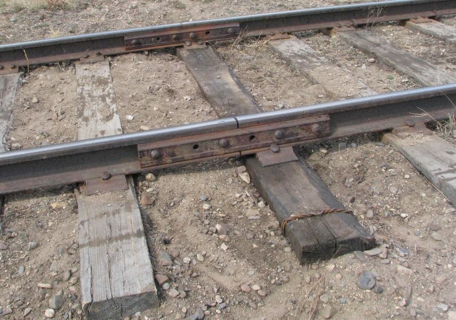

If you own rail track or rail yards, here is the kind of inspection notes you want to be alert about. As a general rule:
  • Watch for clusters of failed ties or ties in poor condition.
  • Correct conditions where there is very little track ballast.
  • Watch for signs of broken bolts, cracked joint bars, etc.

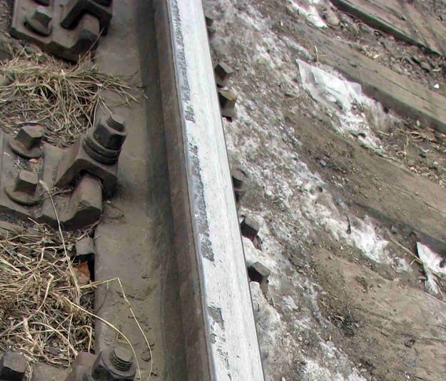

  • Watch for steel rails worn to a point where ~30% of the total railhead has worn off:
    • rail should be replaced at ~3/4 inch of wear for 130-pound size rail
    • rail should be replaced at ~1/2 inch of wear on 100# rail

A branch line with no ballast – moving 3 million freight tons a year in 2008. Not a track maintenance best practice!
(Photo: Jim Blaze)
An example of steel rail head damage from 2007.
(Photo: Jim Allen)
