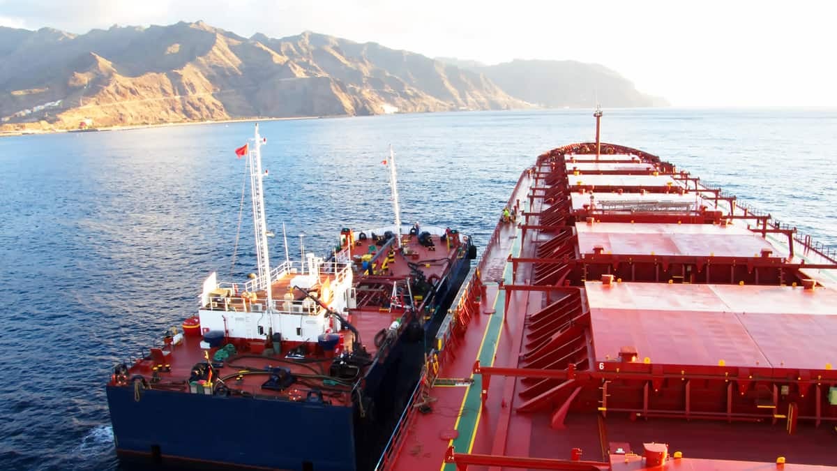

Bunker refueling operations are about to radically change. (Photo credit: Shutterstock)
Utilize ultra-low or very-low sulfur fuel oils
The most efficient solution for ocean carriers looking to meet IMO 2020 compliance requirements is to choose a low sulfur fuel, which requires costly investments in vessel upgrades. The initial quality of very-low sulfur fuel is likely to vary significantly according to local refinery configurations, as the current ISO specifications for petroleum marine fuels do not account for blended fuels. Carriers will need to watch for problems with incompatibility. It is imperative to keep different batches of fuels separate to avoid undesired reactions.

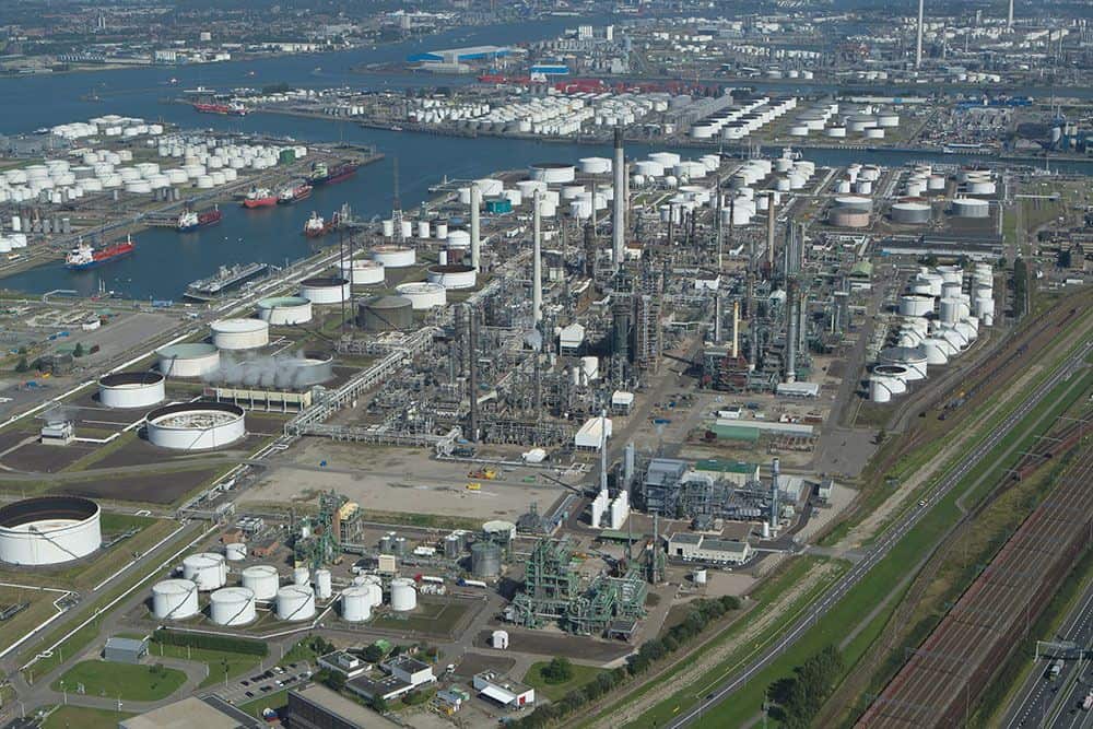

Exxon Mobil’s Rotterdam refinery, which is preparing to sell IMO 2020 compliant fuel (Photo credit: Port of Rotterdam)
Switch to alternative fuel options
Carriers can leverage several alternative fuel options, most of which are non-petroleum based. Liquefied natural gas (LNG) is a credible option as it is nearly sulfur-free and produces lower levels of nitrogen oxides (NOx) and particulate matter (PM) for reduced air pollution. Unfortunately, alternative fuel sources are not readily available on a large scale at this time.
