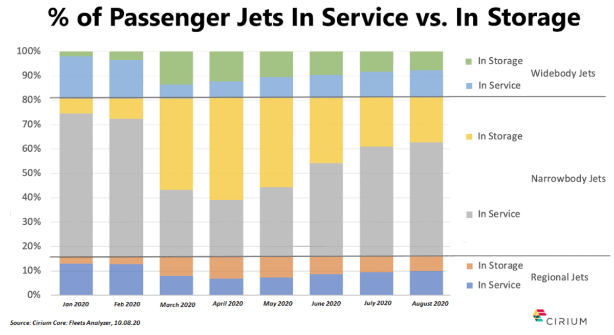

The top three storage locations are in the U.S.: Roswell International Air Center in New Mexico; Pinal County Airpark in Arizona; and Victorville Southern California Logistics Airport, with about 900 planes combined, according to Cirium.
The percentage of passenger jets in storage continues to fall, but a third of the global fleet remains grounded. As of Aug. 10, Cirium classified a total of 8,750 widebody, narrowbody and regional jets in storage status, while nearly 17,500 were in service. During the spring, more than two-thirds of the global feet was in storage.
Recent outbreaks and the end of summer vacations are dampening bookings and forcing airlines to slow their restart campaigns.
Airlines are bringing back their newest aircraft first because of better operating efficiencies. Cirium said that fewer than half of passenger jets built prior to 2013 were used for commercial flights two weeks ago. The most active aircraft were built in 2017. The grounding of the Boeing 737 MAX fleet left fewer 2018 aircraft available for service, it noted.
Airlines are also prioritizing narrowbody aircraft because most of the uptick in travel demand is on shorter domestic and regional routes. Only 29% of the global fleet remains inactive, while 37% of regional jets and 43% of wideobodies have yet to return to duty, Cirium said.
