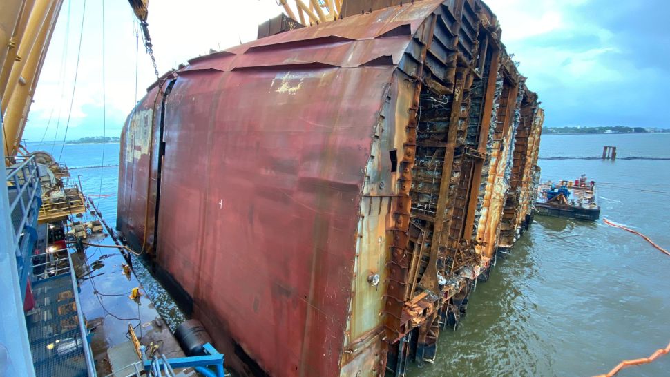

Golden Ray wreckage remains in St. Simons Sound
Cutting operations concluded earlier this month and only two separated hunks of the wreckage remain in St. Simons Sound.

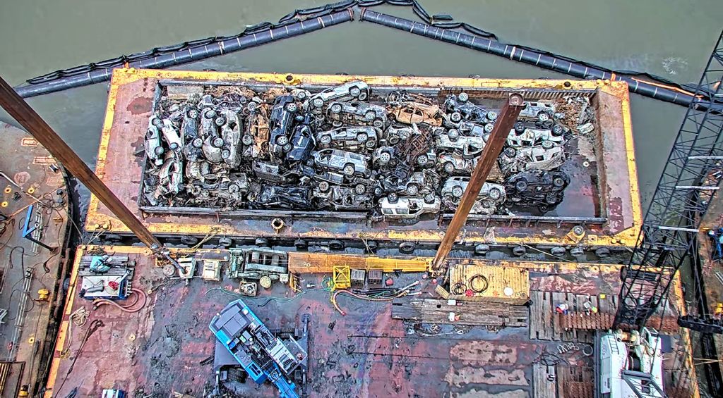

St. Simons Sound Incident Response said 266 vehicles were removed from one of the remaining sections last week.
“In addition to ensuring a safe lift of the section, weight shedding also increases the safety of dismantling operations,” it said. “Any sunken debris that remains inside the environmental protection barrier will be removed after the wreck sections are removed.”
All eight sections are being transported individually by barge to a recycling facility in Louisiana.
