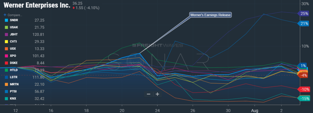

Wall Street trashed the stocks of the large asset truckload carriers on the back of record earnings and high performance among nearly every carrier. Werner (NASDAQ:WERN) was the first major truckload carrier to report, trouncing analyst consensus by over 11 cts per share. This 18% out performance was rewarded with a massive sell-off of the entire sector. This only reinforces the view by many truckers that most people love to hate the trucking industry: do bad, you will be punished. Do great things and you will be punished.
 SONAR Showing truckload carrier stock prices during the earnings season. werner kicked off earnings, so we are highlighting their chart.
Before Werner reported on July 23rd, truckload stocks were recovering from the sell-off from panicked traders over tariffs. As soon as trading opened on the 24th, the sell off began. The worst performer of the pack this earnings season was Knight-Swift (NYSE: KNX). The newly merged company of Knight and Swift missed by a penny, resulting in a sell off of more than 15% since the third week of July. Universal Holdings (NYSE: ULH) and Pam Transport (NASDAQ: PTSI) have not been caught up in the selling. Universal Holdings saw the price of it’s stock increase by nearly 25% and Pam is up 21% in the same period. All of the other truckload carriers are flat or down since July 23, 2018.
The view that traders took was too much of a good thing, is a bad thing. The thesis is that carriers reported the best earnings in their history, and because the metrics were so strong, it will create a run-up in capacity entering the market, eroding pricing power for carriers.
This cycle of boom and bust has played out before and investors think history will repeat. While one could suggest that Werner’s earnings set the market into flames, we believe something else prompted the emotional reaction of traders in the market.

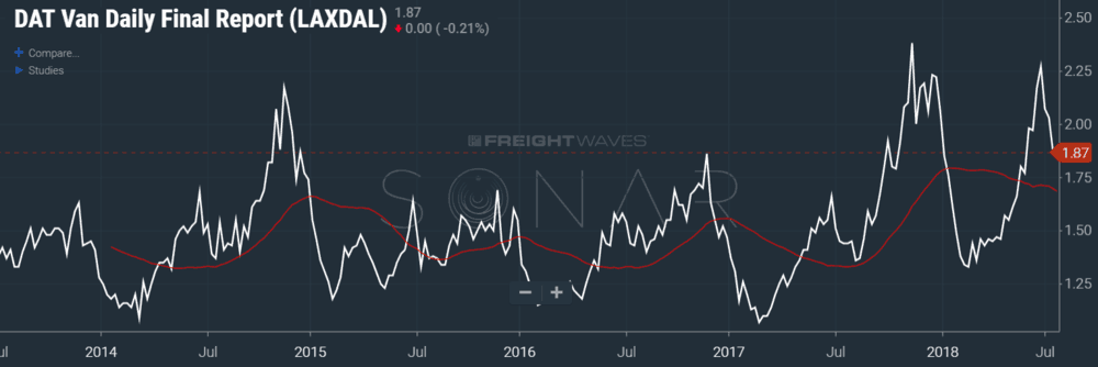

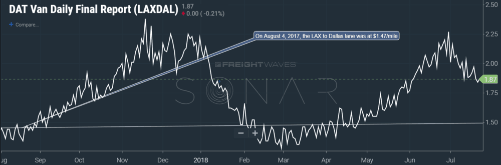

Spot rates are still at record highs, even in one of the slowest times of the year. One of the most volatile lanes in the market is the Los Angeles to Dallas lane. It is also one of the lanes that is most exposed to changes in trade flows from the ports.
 Source: DAT (SONAR:DATVF.LAXDAL) On August 4, 2017 the DAT Truckload Van Index Los angeles to dallas was sitting at $1.47. One year later, it's up $.40/mile.
Source: DAT (SONAR:DATVF.LAXDAL) On August 4, 2017 the DAT Truckload Van Index Los angeles to dallas was sitting at $1.47. One year later, it’s up $.40/mile.
Over the past twelve months, the DAT spot lanes are showing rapid inflation and have sustained record levels. The Los Angeles to Dallas lane, one of the largest freight corridors in the country is at $1.87 a mile, up $.40 a mile from this time last year. It pulled back from $2.27 a mile a few weeks ago after experiencing an unprecidented second quarter surge. Even since the start of the second quarter, the lane has appreciated by $.37/mile (it was at $1.50 on April 3rd).
Put into historical perspectives, the chart is even more impressive.
 Source: DAT (sonar:DATVF.Laxdal) truckload van index for los angeles to dallas over the past 5 years.

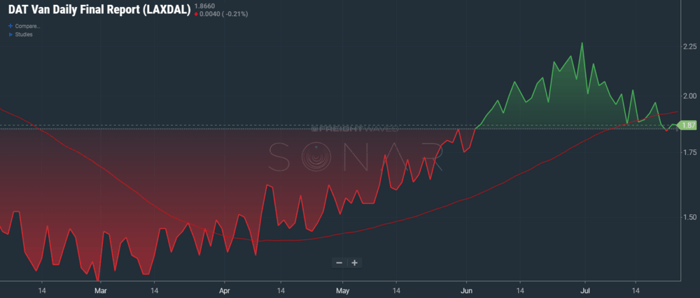

Going back to 2014 (the peak of the last freight cycle) the highest number posted in July was $1.61. This July 2018, the highest posted rate was $2.09. The smallest number in July 2014 was $1.37/mile, in 2018 it was $1.83/mile. Backing out the inflation in driver wages (fuel surcharge is taken out of the numbers), the net increase to operating profits should be around $.25-40/mile for loads on this lane. This results in nearly 20% of the load going towards contribution margins, most of which flow into the profits of the carriers.
The other interesting data point is to look at last July from a historical perspective. The freight market always pull back until late summer. In June 2017, the LA to Dallas lane peaked at $1.66 a mile (up from $1.29 to start the 2nd quarter). It then dropped back to a 2nd half low of $1.34 on August 21, 2017. This 19% drop was followed by a bang up rally that peaked on November 12, 2017 at $2.38/mile (a 75% surge from the August low).
Since the start of Q3 2018, we have dropped back 21% on the Los Angeles to Dallas lane, a similar drop to what we saw last year. If we are near the bottom of the chart on this lane, we could see an amazing rally to end the year.

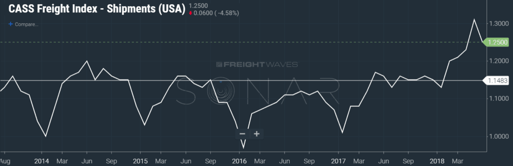

 Cass freight index-shipments (sonar: cfis.usa)
Volume of shipments have increased 8.8% since July 2014 according to the Cass Freight Index.

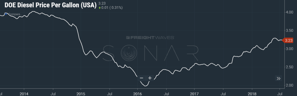

In theory, lower oil prices should be great for carriers because their costs of diesel would be lower. But most truckload fleets have little, if any, exposure to diesel price volatility. The price of diesel is passed on to shippers in the form of fuel-surcharges, allowing them to recoup their costs. In the universe of truckload data that we track, net fuel expenses are around 5% of revenue for all mid-sized carriers. The largest fleets (especially the public ones) have better buying power for fuel, more fuel-efficient trucks, incentive programs for drivers, and better shipper contracts, fuel can actually be cost neutral. With this being the case, carriers should not be concerned about higher fuel costs dragging down earnings and if higher oil prices result in more freight demand and economic expansion, then trucking board rooms are long oil.
 doe diesel price per gallon averages (SONAR: DOE.USA)
As Sam Tibbs, FreightWaves’ own oil economist likes to remind us, for every fracking rig created in the U.S., it adds 1.1 million truckload miles to the market. As oil production increases, so does demand for trucking services in/out of oil wells. Commodities such as metals and sand are used to extract the oil from horizontal wells.
Oil also pumps lot of money into the domestic economy that flows into other sectors. This multiplier effect creates consumer and manufacturing demand, driving other sectors of the freight economy. For truckers, high oil prices are truly black gold.
