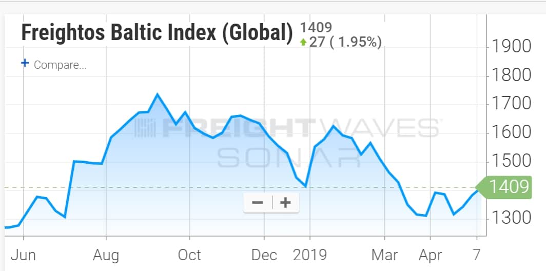

The underlying box freight rates are reflected in the Freightos Baltic Index, which tracks rates on various lanes for 40-foot containers. The global index shows a pronounced rise in the second half of 2018, as U.S. importers raced to bring in cargo before tariffs went into effect, followed by lower rates in the first half of this year. In contrast, charter rates for larger box ships have increased substantially in the first half of 2019.
