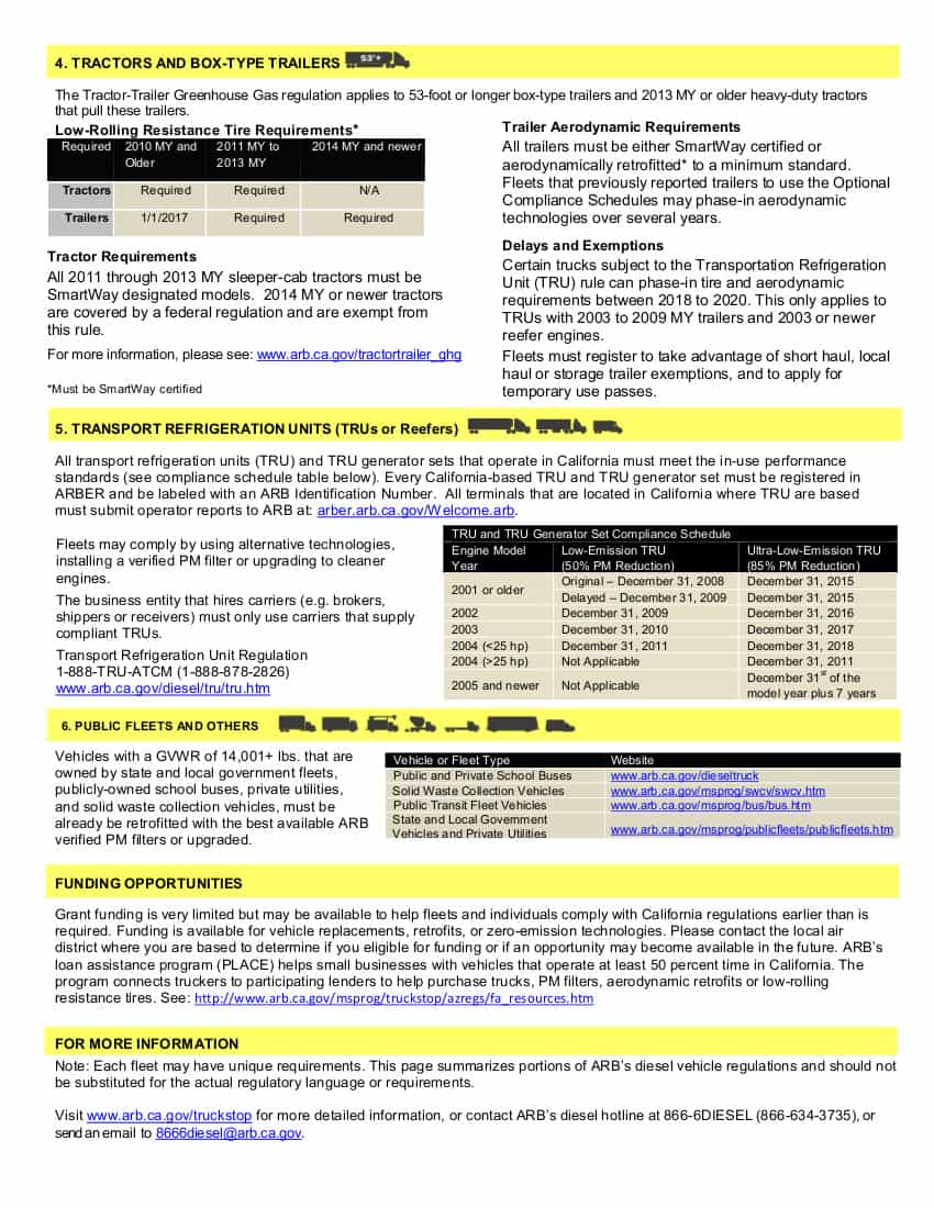

For tractors and trailers, there are also regulations that must be met.
Tractors: All 2011 through 2013 MY sleeper-cab tractors must be SmartWay designated models. 2014 MY or newer tractors are covered by a federal regulation and are exempt from this rule.
Trailers: All trailers must be either SmartWay certified or aerodynamically retrofitted to a minimum standard. Fleets that previously reported trailers to use the Optional Compliance Schedules may phase-in aerodynamic technologies over several years.
A copy of the major truck environmental regulations in California
(Click to enlarge)
Even refrigeration units must meet regulations. The Transport Refrigeration Unit Regulation (TRU) requires “all transport refrigeration units (TRU) and TRU generator sets that operate in California must meet the in-use performance standards (see compliance schedule table below). Every California-based TRU and TRU generator set must be registered in ARBER and be labeled with an ARB Identification Number.”
