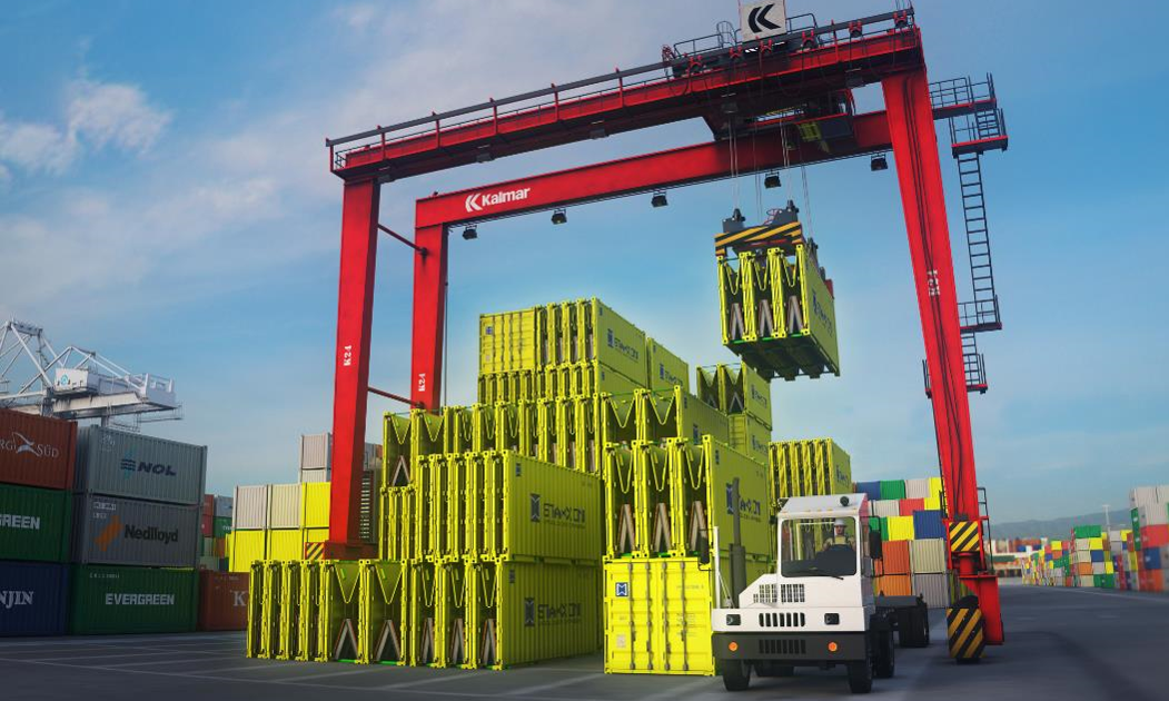

The folding and unfolding process
Staxxon’s containers can be transported with two to five empty containers in the space of one ISO container.
(Image: Staxxon)
