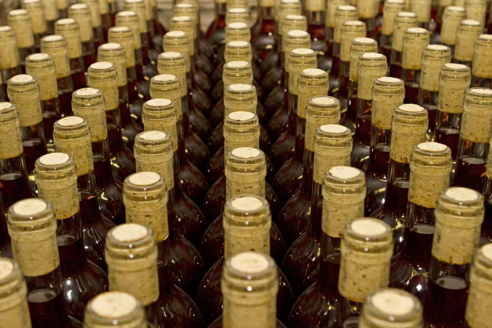

The reason more wine is being shipped by sea in flexitanks as opposed to bottles is, again, cost. “You’ll get 9,000 bottles of wine into a 20-foot container. In a flexitank, the 24,000 liters is the equivalent of around 30,000 bottles, so there’s your answer,” said McClean.

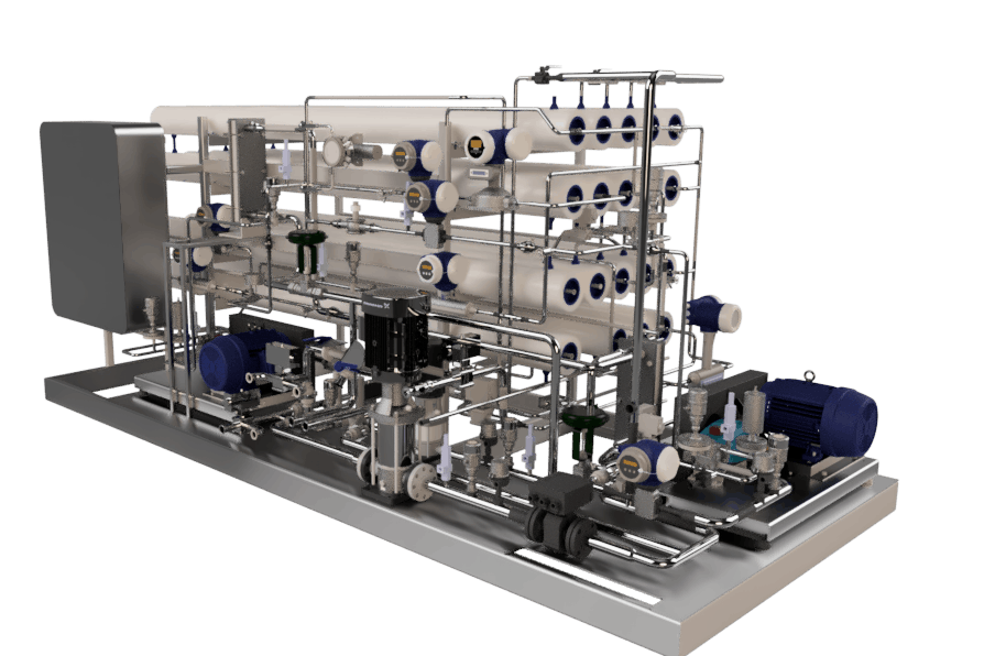

This is the path being pursued by Massachusetts-based Sandymount Technologies, a startup that claims its Revos membrane-based technology can remove water from beer without impacting taste. The resultant ultra-high-gravity (i.e., ultra-high-density) beer is transported in much lower volume, with the water added back in before consumption. The system is designed to operate at a scale of 20 million liters per year.
Sandymount CEO Ronan McGovern told FreightWaves that his technology has been tested with three big-name brewers. The first kegs using the technology are being sent this week and a high-scale contract using both kegs and flexitanks should be operational next year.
“With our technology, we’re able to fit eight times the amount of beer into a container than with bottles, so you’re taking seven containers off the ocean,” said McGovern.
