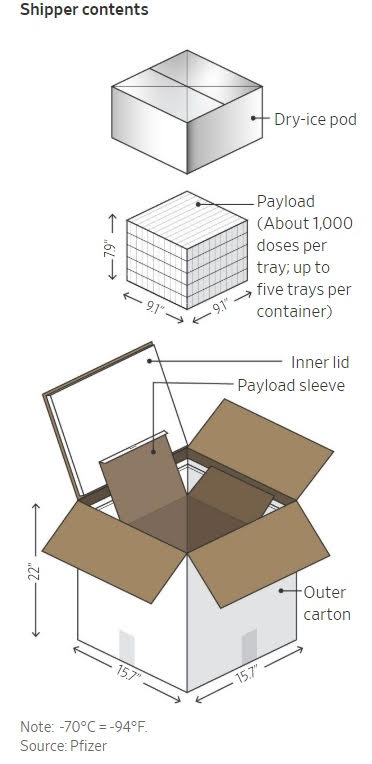

CS: The Pfizer vaccine candidate is the only Operation Warp Speed contracted product that would require ultra-low-temperature handling. Pfizer is also making its own dry ice.
Pfizer developed a special shipping box that uses dry ice to hold between 975 doses and 4,875 doses of vaccine. This shipping container is essentially 20 inches by 20 inches by 24-inch box with different thermal layers in it, and these shippers have what’s called a passive time-temperature indicator to maintain cold-chain quality control.
According to tests by Pfizer, unopened, these Pfizer shipper boxes maintain minus-80-degree Celsius for up to 10 days. Operation Warp Speed received a sample of the shipper at headquarters and has been going over the product daily. We are picking it apart and putting it back together to make sure we understand it.
