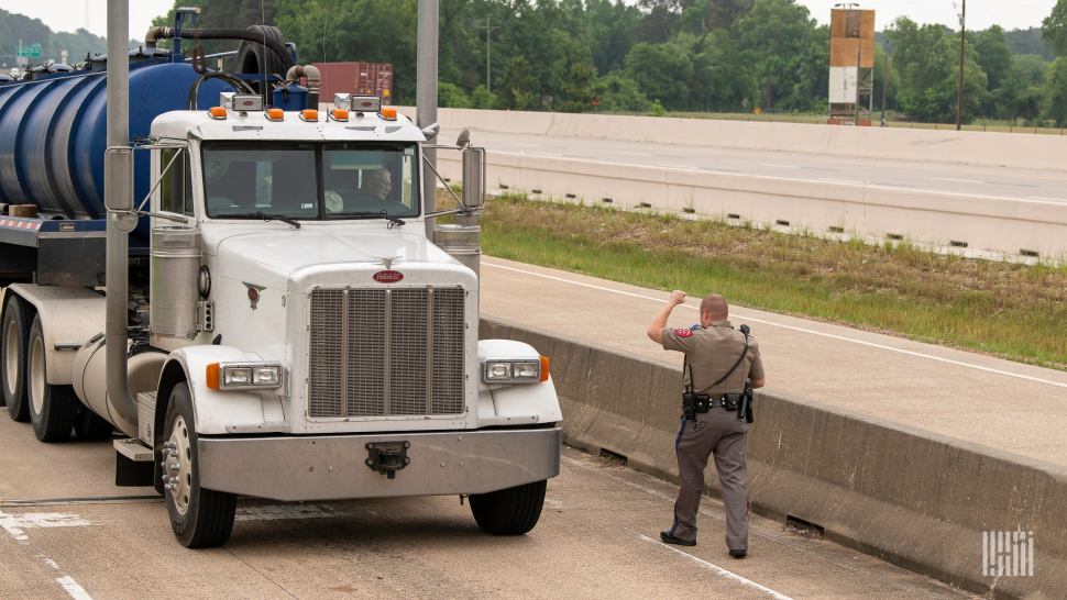

Coinciding with Brake Safety Awareness Month, the Commercial Vehicle Safety Alliance has slated Brake Safety Week for Aug. 22-28, meaning drivers and carriers have just a few more days to tighten up on brake safety.
Over the seven-day period, inspectors will conduct North American Standard Inspections of commercial motor vehicles with a focus on brake systems and components, removing any inspected vehicle found to have brake-related out-of-service violations. CVSA will then compile data collected on brake hoses and tubing, which are the areas of focus for this year’s inspection, and in turn, publish a report of its findings later this year.
