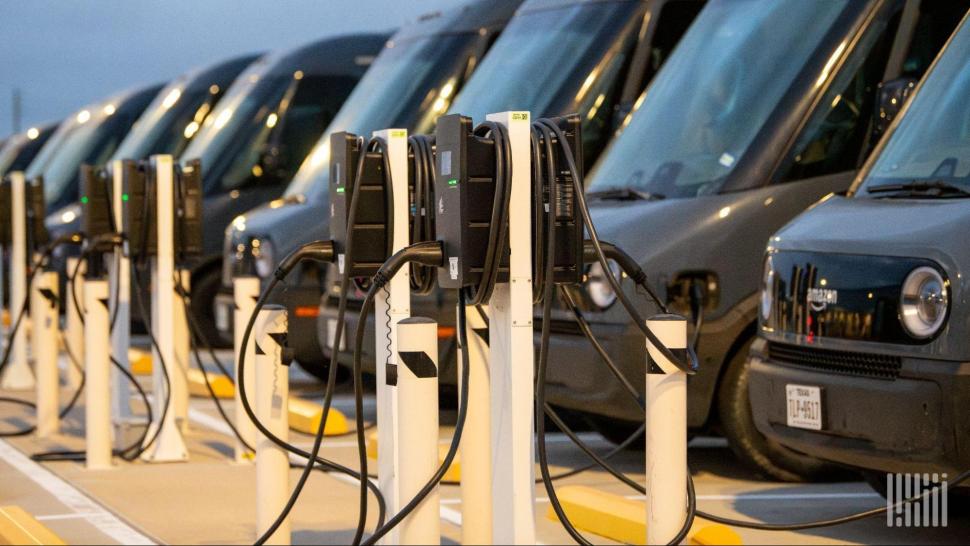

The alternative: a dense network of slower chargers managed by software. Fifteen 7-kilowatt chargers instead of one megawatt unit gives a fleet redundancy. If a few go offline, the operation keeps moving. Staggered charging means no single moment of peak demand.
