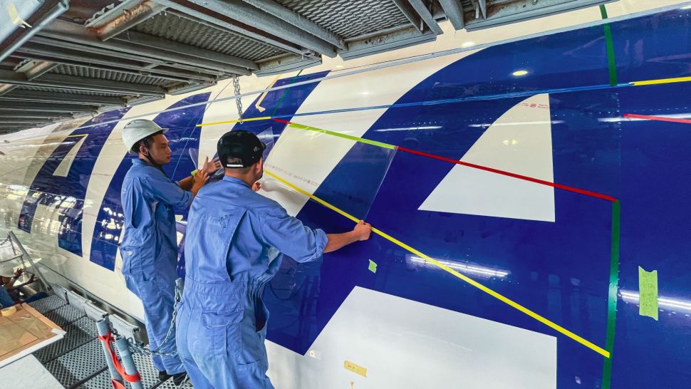

Airframe repair specialists apply the AeroShark technology to an All Nippon Airways 777 freighter. (Photo: Lufthansa Technik/ANA)

Aircraft surfaces are exposed to UV radiation as well as temperature and pressure fluctuations at high altitudes that can alter smoothness. The low-friction film consists of riblets – small protrusions measuring about 50 micrometers or 0.002 inches – that imitate the hydrodynamic properties of sharkskin and allow air to flow more smoothly over the aircraft during flight. The subsidiary of Deutsche Lufthansa AG estimates the riblet film, which is applied to most of the fuselage and engine nacelles during scheduled maintenance layovers, reduces drag by about 1%.

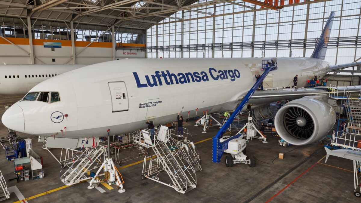

Workers apply the AeroShark surface technology to a Lufthansa Cargo B777 freighter. (Photo: Lufthansa Cargo)
The sharkskin modification’s ability to reduce friction and emissions is slightly better on cargo than on passenger aircraft because the film is applied to a greater area due to the absence of windows, according to BASF.
An All Nippon Airways maintenance contractor applied the specialty film to the 777 freighter, which the airline says will reduce fuel use by 275 tons and greenhouse gas emissions by 881 tons per year. ANA said it will evaluate the real-world effectiveness of the technology in daily operations before deciding whether to expand its use to other 777 aircraft in the fleet.

Lufthansa Cargo, which operates 18 B777 cargo jets, was the first to adopt the sharkskin technology in 2023. It has modified five 777 freighters so far and plans to gradually apply the coating to the remaining fleet by 2027, spokesman Jan Paulin said. Lufthansa Cargo has previously said that it will save more than 4,400 tons of jet fuel per year across its entire 777 fleet, which corresponds to about 53 cargo flights from its base in Frankfurt, Germany, to Shanghai.
