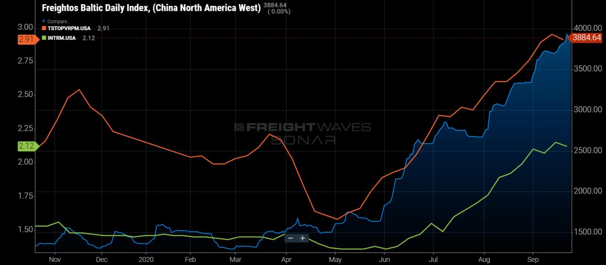

Chart of the Week:  Freightos Baltic Daily Index – China to North America West Coast, Intermodal Spot Rates, Truckstop Dry Van Rate per Mile – USA SONAR: FBXD.CNAW, TSTOPVRPM.USA, INTRM.USA
Spot rates for shipping ocean containers, dry van truckload and intermodal containers are all hitting multiyear highs in almost pure synchronicity — an indication that shipping demand is strong across global supply chains.
The spot market may not be the largest volume of transactions in transportation, but it has long been considered a good barometer of capacity. When shipping demand exceeds the supply of capacity, rates increase. Conversely, when supply exceeds demand, rates decline. This is a bit of an oversimplification, but the core principle is what is important to understand.
The Freightos Baltic Daily Index in the chart represents the average spot rate for shipping a 40-foot container from China, the U.S.’s largest overseas trading partner, to ports on the North American west coast.
Rates were under $1,300 in this lane at the end of February but have increased to over $3,800 this month. Initially, rates were inflated based on the assumption that demand would be down. This led maritime carriers like Maersk to remove ships from service. Once China resumed production, rates increased slowly through April and May until taking off in early June.
Once the carriers realized shipping demand had resumed, they began to put ships back into service but demand continued to outpace available capacity, leaving the rate at its highest point in years.
Trucking spot rates were next, bottoming in late April and peaking this month, according to Truckstop.com. Intermodal spot rates, which represent the smallest percent of the total volume for the mode, did not begin to increase until mid-June and increased dramatically through July and August as rail carriers priced themselves out of business on the West Coast.

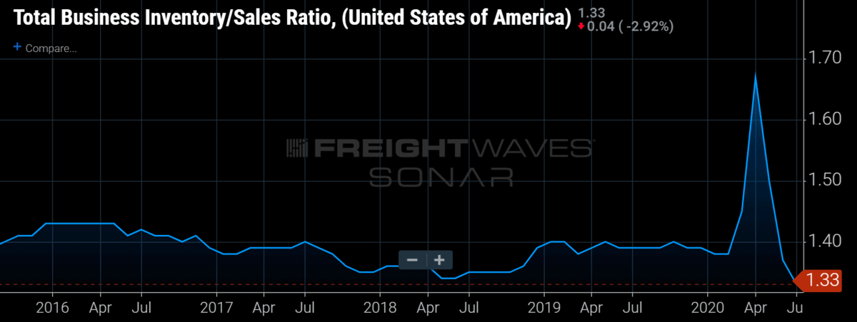

The ratio of inventory to sales ratios climbed in 2019, while companies struggle to keep enough on hand halfway through 2020. Chart: SONAR – TBIS.USA
Essentially, they were keeping higher inventory levels than they normally would in case their sourcing was no longer available or costs increased. This is reflected in the total business inventory to sales ratio produced by the Census Bureau each month. The average inventory levels increased from 1.36 months of inventory on hand in 2018 to 1.39 in 2019.
Most of the freight that entered through the ports was sitting in a warehouse in 2019, meaning it was not getting placed on a long-haul truck. In 2020 demand for items that were not forecast to grow at a double-digit pace has forced shippers not only to react quickly to the unexpected demand, but also prepare for what else they may not see coming.
