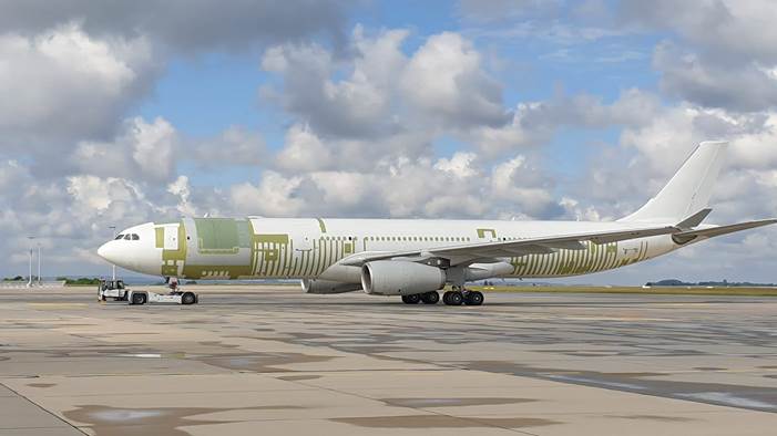

In August, Air Transport Services Group (ATSG) announced plans to purchase and convert 20 passenger Airbus 330s to lease to its express delivery operators. Germany-based aerospace manufacturer EFW won the contract and will begin those conversions in July 2023.
At first glance, ATSG’s deeper investment in the Airbus family is a simple story of modernization as the A330’s medium widebody presents a fine alternative to the Boeing 767-300, which only has a limited amount of feedstock availability.
“We’re certainly not abandoning the 767,” said Mike Berger, ATSG’s chief commercial officer. “We still have 30-plus conversion slots left to deliver a 767, but feedstock becomes thinner and thinner. The A330 was just the natural progression, as feedstock availability is excellent and it complements well with our joint venture with Precision on the A321 narrowbody freighter but provides cockpit commonality with the widebody A330 conversion. The A330 offers more capacity than the Boeing 767-300 with 26 main deck and 32 lower deck positions, fully containerized.”
An additional merit of the A330: its fly-by-wire cockpit, which allows pilots to easily transition between the A330 and A321. The cockpit commonality between the two Airbus models offers a huge advantage over the Boeing aircraft family, said Wolfgang Schmid, vice president of sales and marketing at EFW. Another advantage of the Airbus conversion is its power cargo-loading system.
“From the loading perspective, the A330 has a nose-down structure, so manual loaders would have had to haul cargo uphill. So we decided to use a powered cargo-loading system,” said Schmid. “We had concerns about the motors breaking or being inflexible in terms of speed, but the new system we implemented is quite the opposite.”
If a part of the powered system does go down, the other part may take over, allowing the operation to proceed. Additionally, the power cargo-loading system is actually faster than manually loading, as two to four containers are getting moved at once. There also are savings in labor, accidents and mishandled containers since only two loaders are needed on the upper deck, as opposed to six or eight.
