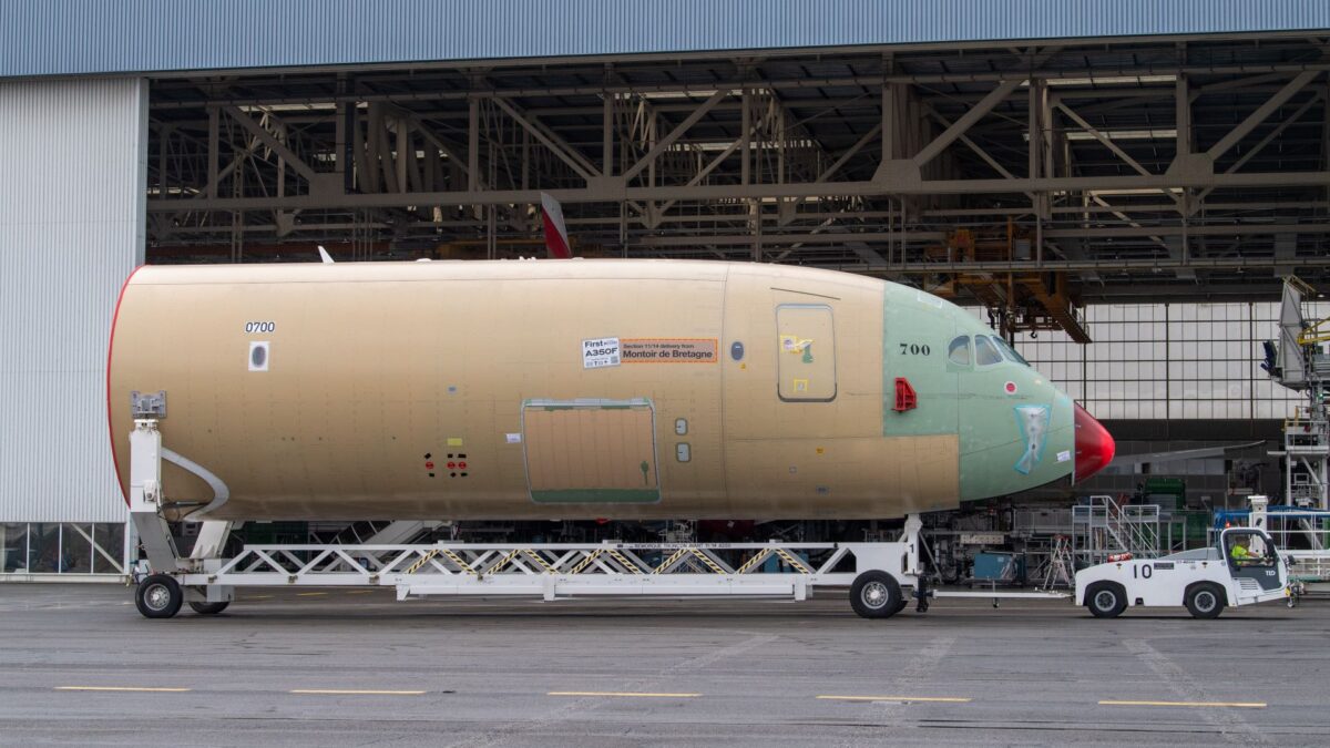

A section of the A350 freighter arrives at Airbus’ Toulouse assembly plant. (Photo: Airbus)
