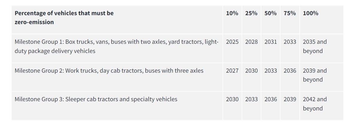

For the larger “high-priority” fleets as defined in the ACF rule, the big decision they face is whether to stop buying ICE vehicles completely next year or begin the transition through use of the “Milestones” that have been established for the transition.
The “no new ICE” provision for high-priority fleets is similar to the rule governing drayage. It takes effect Jan. 1. The Milestones are the alternatives for high-priority fleets and it takes a table to understand how they work.
This is the table provided by CARB for the milestones.
Source: CARB
“You’ve got to be a mathematician to figure out where you fall with the percentages and the different groups of trucks,” Glen Kedzie, a principal at E&E Strategies, told FreightWaves. Kedzie is a former official with the American Trucking Associations who has his own consulting company and clean fleet rules along with government relations are an area of specialty.
Despite that, “I would guess that fleets would go with the Milestone schedule,” Kedzie said. “I think there’s more flexibility involved. You gain a little more time.”
Paul Arneja, CARB’s lead staff on the ACF, said in an interview that he also believes the Milestones pathway is most likely to be chosen by high-priority fleets to comply.
“There are two options available for high-priority fleets, but both of them will eventually reach the same place,” Arneja said. “But the path to get there will be different.” Echoing Kedzie, Arneja said the Milestones pathway “has more flexibility and a staggered timeline for the longer range and more specialized vehicles. So we do think that will be the preferred option for most fleets.”
The flexibility comes in the fact that if a fleet chooses to go the Milestones route, it can continue to add ICE vehicles, as long as the overall percentage of ZEVs in the fleet hits the Milestones targets.

  • The requirements under Milestones are across all the subcategories within each group. For example, under Milestone group 1, which has a 10% ZEV requirement by 2025, the components include five types of commercial vehicles: box trucks, vans, buses with two axles, yard tractors and light-duty package delivery vehicles. Cocca said the 10% would be applied to the entire fleet. The requirement is not that a fleet has 10% ZEVs in all those categories.

That has led to some confusion in the media, which has declared that the state has a goal of all ZEVs by 2036. For sleeper cab tractors, the Milestone that would bring an end to ICE vehicles is that 100% of all fleets are required to be ZEV by 2042. By contrast, Milestone Group 1, which includes box trucks and vans, is looking at a 100% ZEV requirement by 2035.
