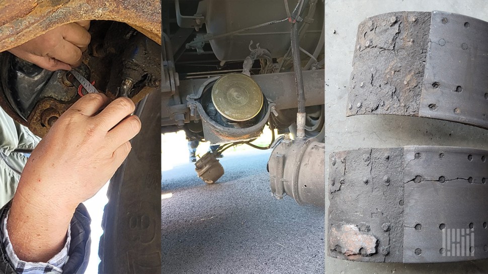

Know What They’re Checking: Brake Component Quick Breakdown
Here’s what they’ll be looking for and what you should be double-checking right now:
  • Brake hoses: Not kinked, cut, swollen or leaking.
  • Fittings: Secure and leak-free.
  • Brake chamber: Properly mounted with no dents, rust or air leaks.
  • Slack adjuster: Pins secured; adjusters straight, not broken.
  • Push rod: No more than 1 inch of movement with brakes applied.
  • Brake drum: No cracks, holes or contamination.
  • Brake linings: At least a quarter-inch thickness, no chips and dry.
  • Rotors/discs: Free of deep heat checks or cracks; smooth and uniform.
  • Air system: Pressure builds to 120-plus PSI, holds steady under application.
  • Air loss test: No more than 4 PSI loss in one minute under applied pressure.
  • Buzzer and pop test: Alarms at 60 PSI, valves pop at 20-40 PSI as required.
