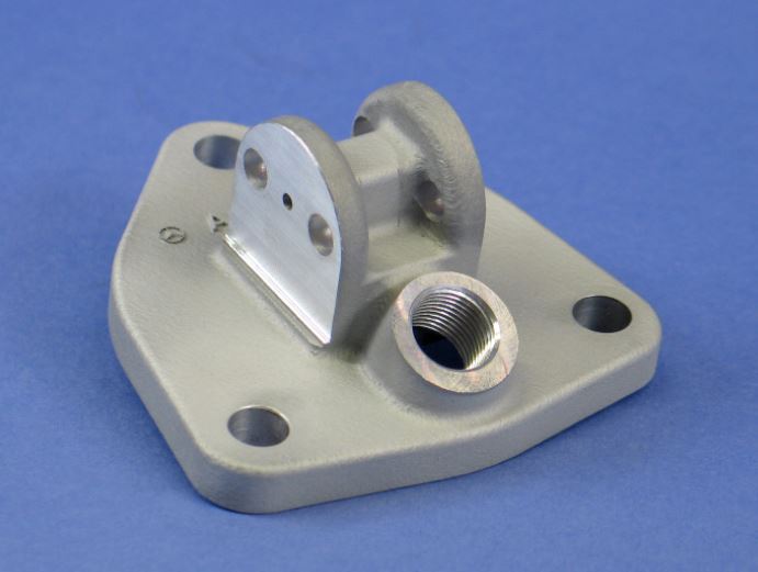

Daimler Trucks uses a digitally created bracket for a diesel engine, the first replacement truck part manufactured at Premium AEROTEC.
This digitally created bracket for a diesel engine is a replacement truck part manufactured as part of a partnership of Daimler AG, EOS and Premium AEROTEC. (Photo: Daimler AG)
