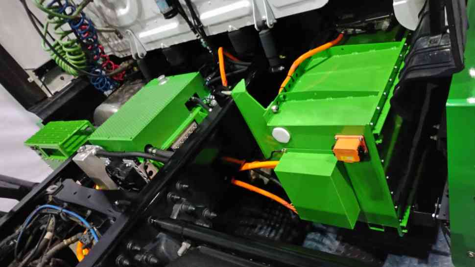

The Hyliion system features a control box, APU and battery pack and it electrifies the rear axle on a tandem tractor axle to generate electricity through regenerative braking.

But, a hybrid solution like Hyliion offers not only introduces electric power to fleets, it saves fuel and cost. Healy said the 6×4 HE electric hybrid product achieves a 30% reduction in fuel use due to three factors. Fifteen percent is achieved through the hybrid technology, 12% from the system’s APU, and 3% from tractor aerodynamics. The Hyliion system comes with tractor aerodynamic panels from FlowBelow.
According to Healy, the add-on system electrifies the rear axle of a tandem axle tractor. Each time the vehicle brakes, the system collects that wasted kinetic energy and sends power into the battery pack or directly into the engine, as needed. Long haul trucks actually brake more than many people believe, Healy noted.

Regenerative braking works by using an electric motor that applies force when the vehicle is going downhill or slowing down. When this occurs, coils in the motor create a magnetic field which applies negative torque on the axle. This negative torque produces a current which recharges the Hyliion battery. This energy creation is about 90% efficient. When the vehicle accelerates or is going uphill, the electric motor provides power to reduce the load on the diesel engine.
